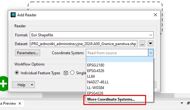

Hello,
is there any version of FMEFORM 2025 that will allow me to select a coordinate system in the reader from outside the short list without automatically closing the entire application? I checked 2025.1.1 and 2025.1.3. or is there any tip to do this? I tried different scenarios and always when i am trying to open More coordinate systems the application closed by itself.
Regards Artur Gustowski

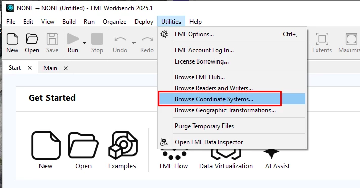

Coordinate systems in FME option shows as bellow:
a Browse Coorinate Systems button closes my workbench as well. I wil try to download and reinstall whole application.

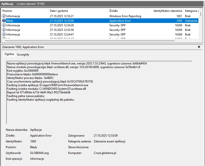

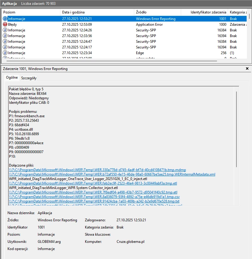

the reinstalation of applications, as you suggested, on my both computers (windows 10 pro and windows 11 bussines OS ) did not improuve the sitaution. I am using previous 2024 version of FME Form. Event report noticed errors.
OS Win11Buss
Application Error
Faulting application name: fmeworkbench.exe, version: 2025.7.53.25643, time stamp: 0x68ddf434
Faulting module name: ucrtbase.dll, version: 10.0.26100.6899, time stamp: 0x59edb1c8
Exception code: 0xc0000409
Fault offset: 0x00000000000a4ace
Faulting process ID: 0x4BDC
Faulting application start time: 0x1DC47383A78375E
Faulting application path: D:\apps\FMEForm\fmeworkbench.exe
Faulting module path: C:\WINDOWS\System32\ucrtbase.dll
Report Id: 671d904e-b716-4b6f-90a3-ff5275b4afd6
Faulting full package name:
Faulting package-relative application ID:

Hmmm. My Polish isn’t very good, but a search on  ucrtbase.dll seems to indicate that some of your windows-files are not entirely ok anymore:
https://learn.microsoft.com/en-us/answers/questions/3850215/application-crashes-due-to-ucrtbase-dll
https://www.autodesk.com/support/technical/article/caas/sfdcarticles/sfdcarticles/Autodesk-Desktop-App-crashes-or-stops-working-with-faulty-module-ucrtbase-dll-logged-in-Windows-Event-Viewer.html
https://forums.tomshardware.com/threads/my-pcs-ucrtbase-dll-somehow-broke.3651272/#post-21998298
and it’s even mentioned on here as well:
Some of these links include ways of solving the problem, maybe they will help you as well. If not, I’d suggest opening a support ticket with Safe.
