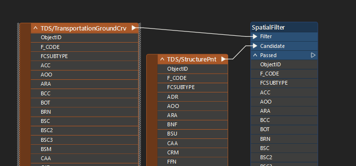

I don’t know if this is a bug in build 25220, or if it’s the intended behavior. But it’s very different from past versions, and will likely cause issues in our workflows.

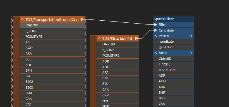

When the ‘Merge Attributes’ option is unchecked, no Candidate attributes are carried forward in the Passed port as a shown in this screenshot. The Candidate attributes are only carried forward in the Failed port.
If the ‘Merge Attributes’ is checked, the attributes are passed:
However, the issue is that there is no configuration in the ‘Merge Attributes’ section that will only pass the original attributes from the Candidate. You are forced to either merge the Filter attributes, create a prefix on the Filter attributes (and likely have to remove in bulk post-SpatialFilter), or simply use the Filter attributes. No option will spatially filter the Candidates without altering the schema.

Hi ​@dustin ,
Apparently it was a initial failure in the FME 2025.0, and seems to be fixed in the current version 2025.0.2 build 25237.

I noticed the same thing the other day (using 2025.0.1), for me the attributes were still there just needed to be exposed. Adding the link to the Known Issues and details for this issue. It is marked as Resolved.
https://support.safe.com/hc/en-us/articles/34243509378061-Known-Issues-in-FME
Transformer Attributes FME Form Transformers have attributes missing that are unexposed attributes that were previously exposed.
Workspaces should continue to run as expected. However, during authoring, attributes appear to be missing, but they are unexposed.
FMEFORM-33479
While authoring a workspace with an affected transformer, AttributeExposer can restore the expected schema
For existing workspaces, run via command line or with FME Workbench despite the warnings.
2025.x
Resolved
2025.0.2
