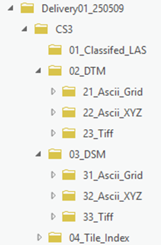

Hi Community,
I’ve developed a workflow that enables me to connect to an external SFTP server and download all contents from a specified folder. I followed the guidance provided in the following post:
The workflow functions well for a single folder. However, the SFTP directory structure includes multiple nested subfolders. I now need to enhance the automation to recursively traverse these subfolders. Please see the structure example below.
Additionally, the SFTP contains files in various formats. To handle this, I plan to use multiple StringSearcher transformers—one for each file type (e.g., .tiff, .asci, .las). My challenge is ensuring that FME iterates through all subfolders to identify and process the relevant files.
Could anyone advise on how to configure FME to recursively search through subfolders and apply the appropriate filters?
Many thanks in advance!
