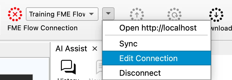

Hi Langley, please include the version of FME form and flow (they should be the same).
Perhaps in FME Form workbench double check you are actively connected to Flow.
