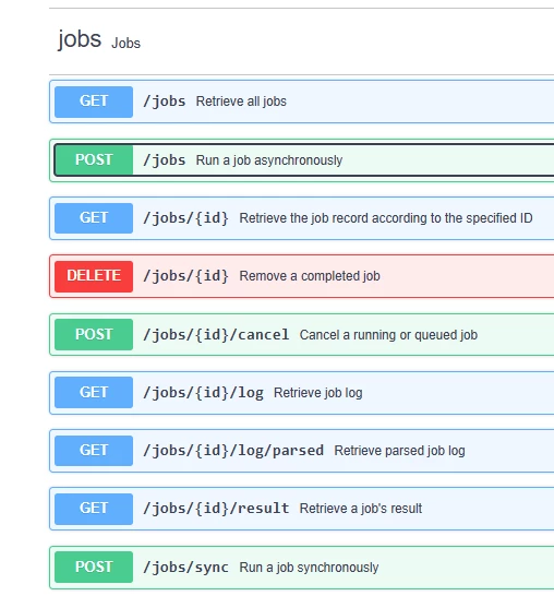

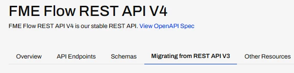

To understand the 2026 changes underneath FlowJobSubmitter due to the REST API v4 check out the documentation
Specifically the migrating tab… to understand how the Jobs endpoint has changed
Description Old location New location
Jobs /transformations/jobs/* /jobs/*
Jobs
  • Submit, monitor, and cancel jobs.
  • Manage job queues and assign engines.
  • Access job logs, statuses, and metrics.
all work with Job_ID
