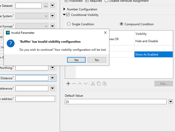

Hi,
I am using FME(R) 2025.0.0.0 (20250228 - Build 25208 - WIN64).
I was glad to see that  with FME 2025 there is now the option to  apply Compound Conditions to the User Parameter display.
However, I believe there may be a bug in the  Compound Condition Dialog settings for the User Parameters.
Any type of compound condition  triggers an “Invalid Parameter” response.
Applying  a Single Condition works fine.
Thanks,
Svea

Hey Svea, would be worth raising this as a potential bug through the support channels; That way the Safe Product Owner can review and direct a fix if applicable: https://support.safe.com/hc/en-us/p/support

Thanks, I have submitted this as a potential bug - ticket reference 54398
