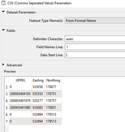

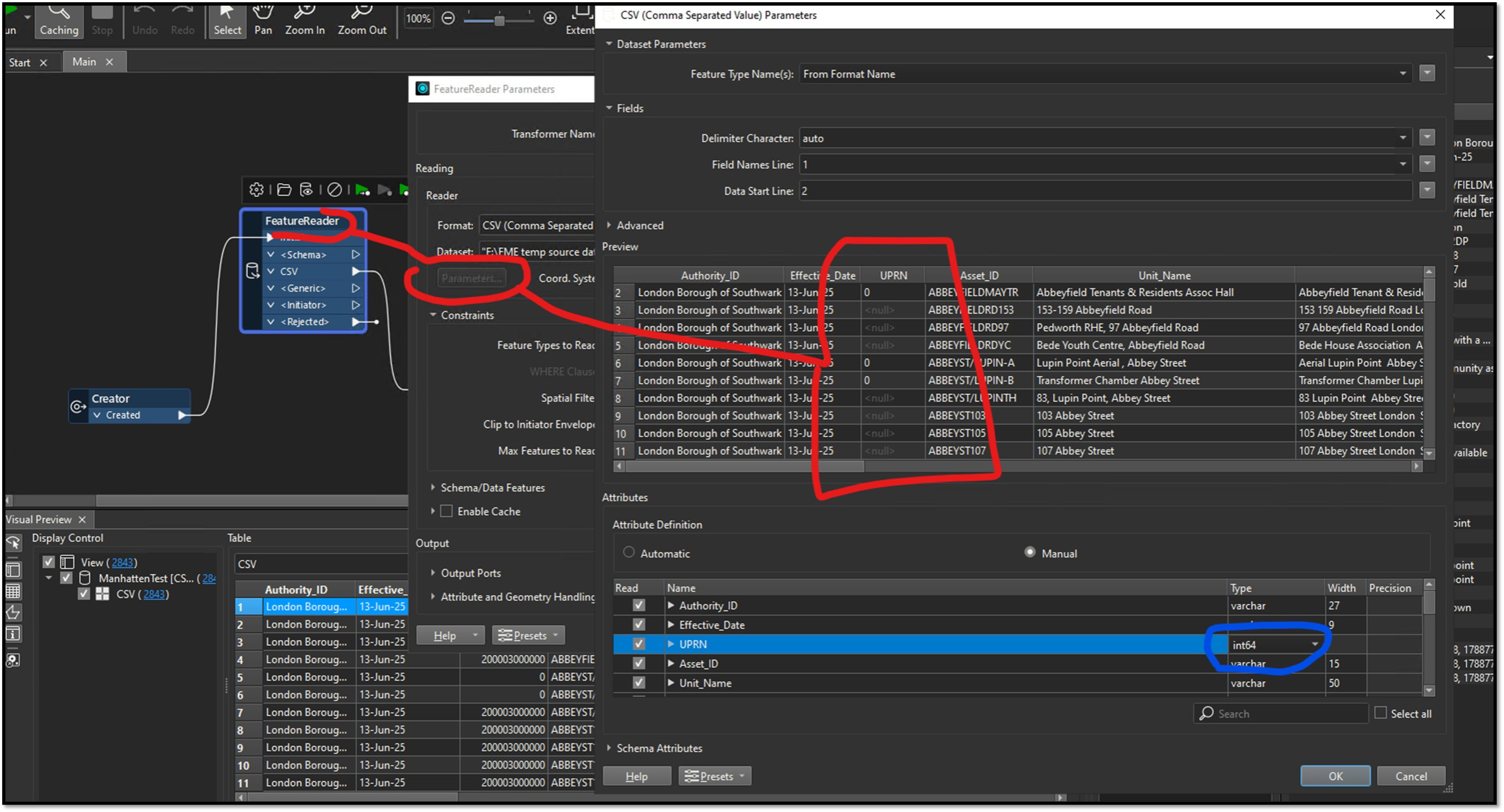

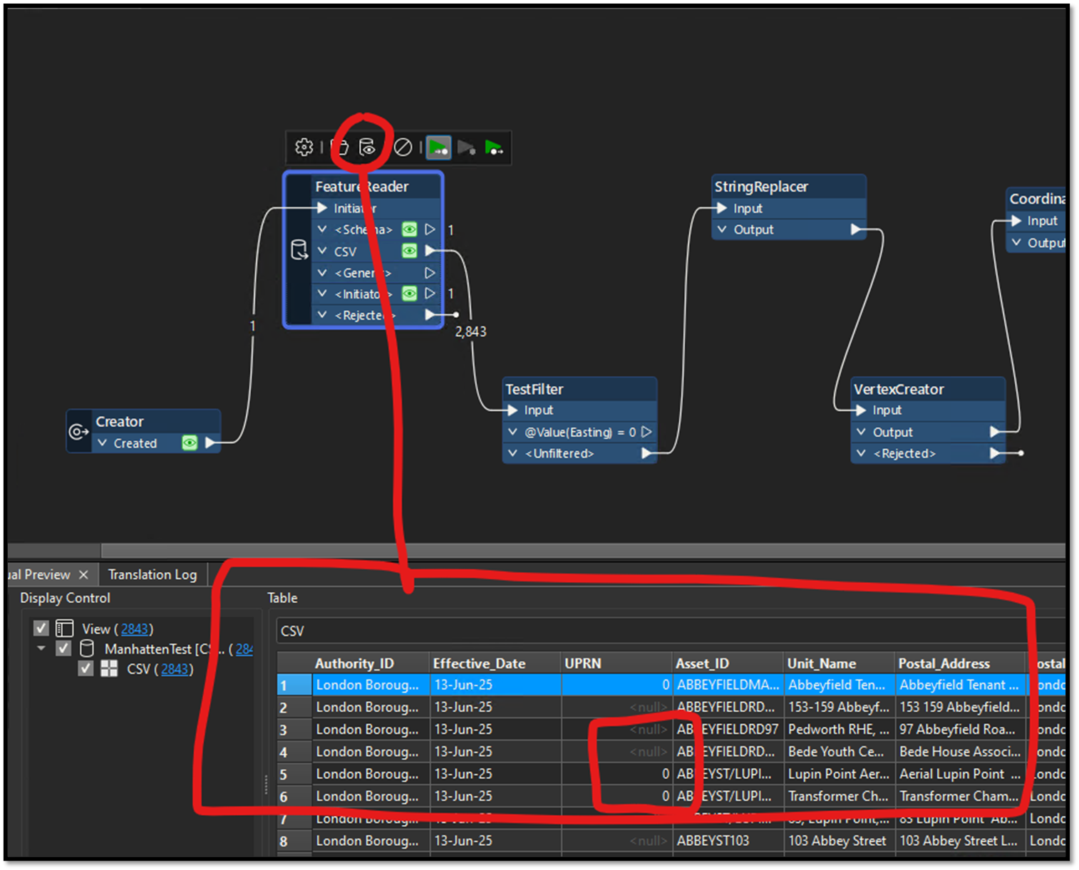

I have a workspace which is reading in a csv containing a field called UPRN. Some of the values are full (e.g.: 200003362891) but some values are zero. This is expected in the data and is fine.
But when read into the FeatureReader the values look like this (when set as Number)…
And if set as Int64 it comes out like this…
How do I force FME to bring in those UPRN values as contained in the source data?

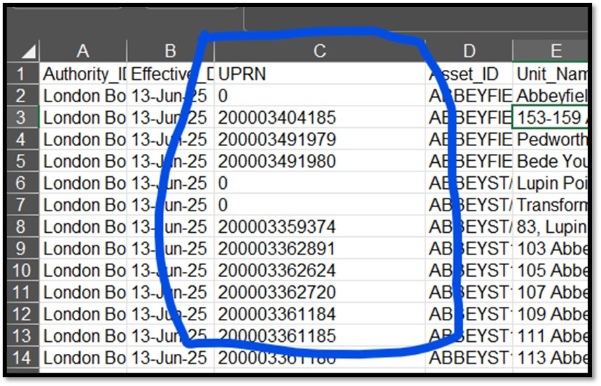

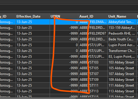

If you view the source csv in a text editor do the UPRNs have an apostrophe in front of them? In your excel screenshot they look like they’ve been set to numbers stored as text
I’m sure I’ve seen similar behaviour when someone has opened and resaved a csv file within excel

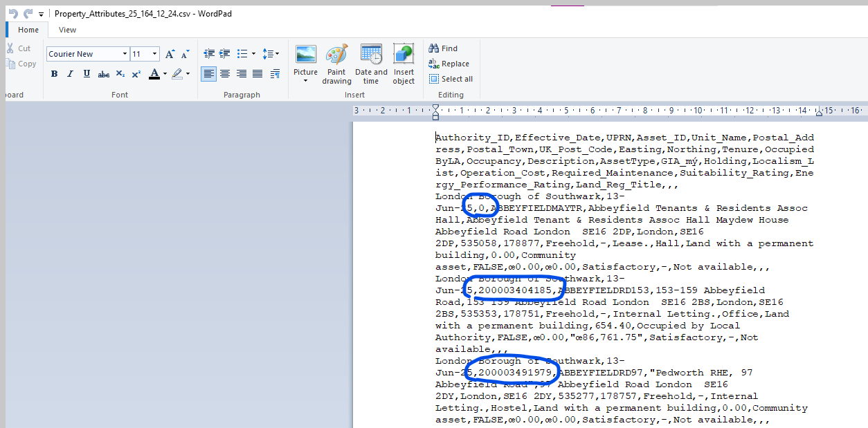

Thanks for that, ebygomm.
The UPRN values, whether they be a full completed number or a 0, are sound when viewed in Wordpad.

I tried to reproduce this is in 2024.2.1. If type is set to number, it returns numbers as expected. int16 returns null. It defaults to uint64, this returns numbers as expected..
Encoding is default set to Windows Latin-1 (windows-1252).

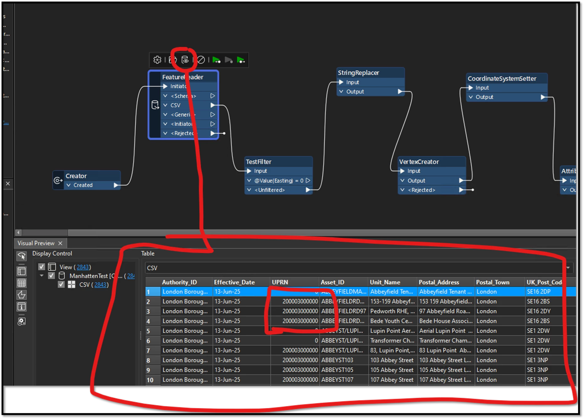

​@nielsgerrits l I have tried ‘Number’ before. But I’ll give it another try.
scarter
Forum|alt.badge.img+10
  • Jun 17, 2025 2:00 PM UTC

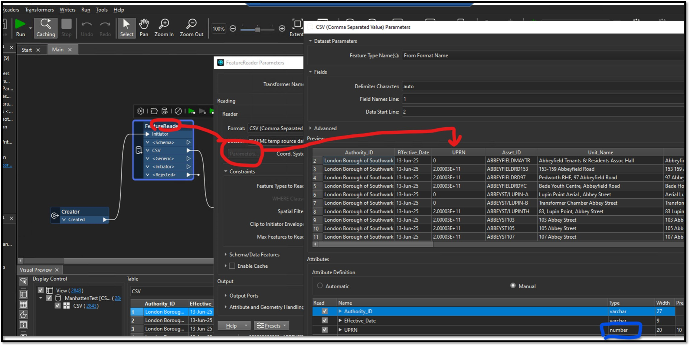

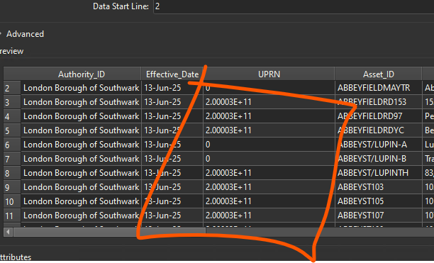

​@nielsgerrits If I change the UPRN attribute Type to ‘Number’ They come out like this in the reader…
And they come out like this in any output…

Hi ​@scarter I believe the scientific exponential notation for the number that you see in the visual preview is only for display, if you were to perform any calculations on this it would output as expected. Assuming you are not wanting to calculate anything from this number perhaps you could try setting the data type to string / varchar?
You can set the data type to be different on the writer / output to match your dataset. What are you integrating with to get the -9999 in the output and what data type is set for that value in the writer?
