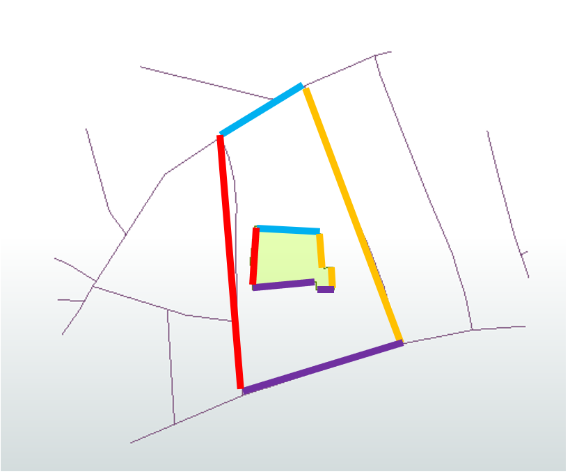

how could we find the closest road facing  the Building  from the North, south, Est and West
the ides is to take each side of the building  check its facing what direction and then towered that direct we should check the closest road we can see from that building side
we are expected to get this result  each color represent the relation

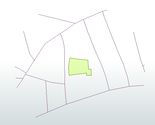

I am attaching this sample data for reference
Thanks

In particular, how are you defining sides? Looking at the image I see what appears to be 2 segments that make up the “red side”, more importantly in the yellow and purple “sides” you have 2 segments highlighted that are disjoint and separated by segments that you have not highlighted. This task may require generalization of the input polygon to some degree depending on your definitions of “side”.

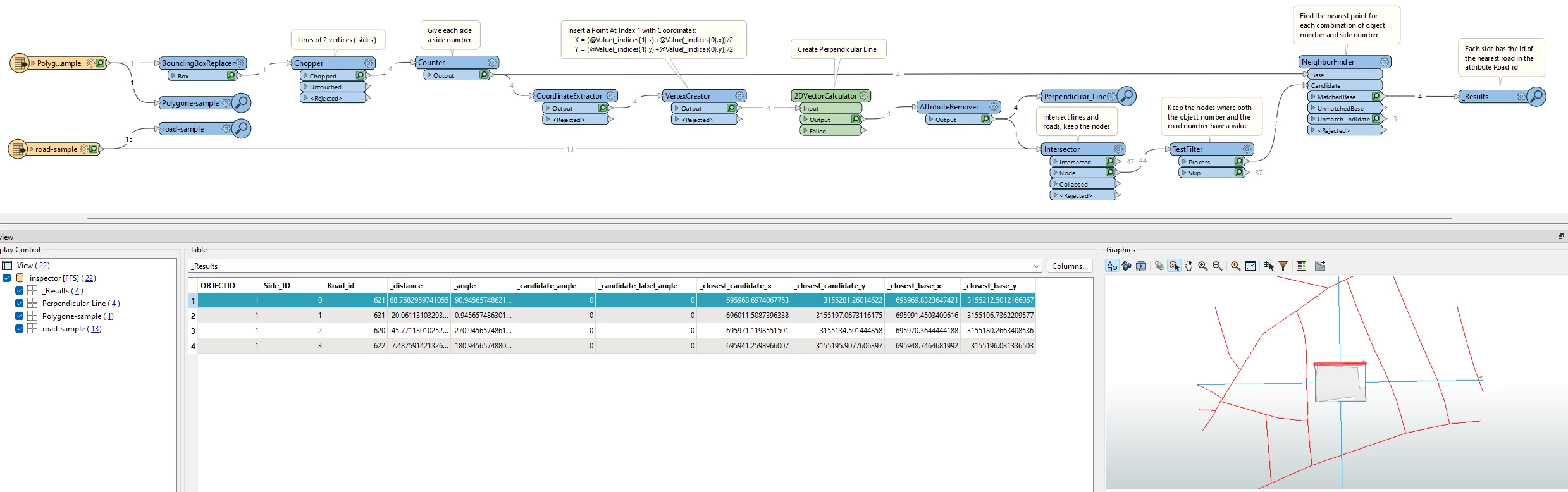

A variant of the process mentoned above:
  1. Create a bounding box over the house shape
  2. Create lines of 2 vertices from the bouding box with a Chopper
  3. Create a perpendicular line to one side, through the midpoint of each line
  4. intersect with the roads
  5. find the nearest intersection for each line
For creating the perpendicular lines I used the 2DVectorCalculator from FME Hub.

​@geomancer
Thanks  I did some adjustment to fit the Geometry Shape
