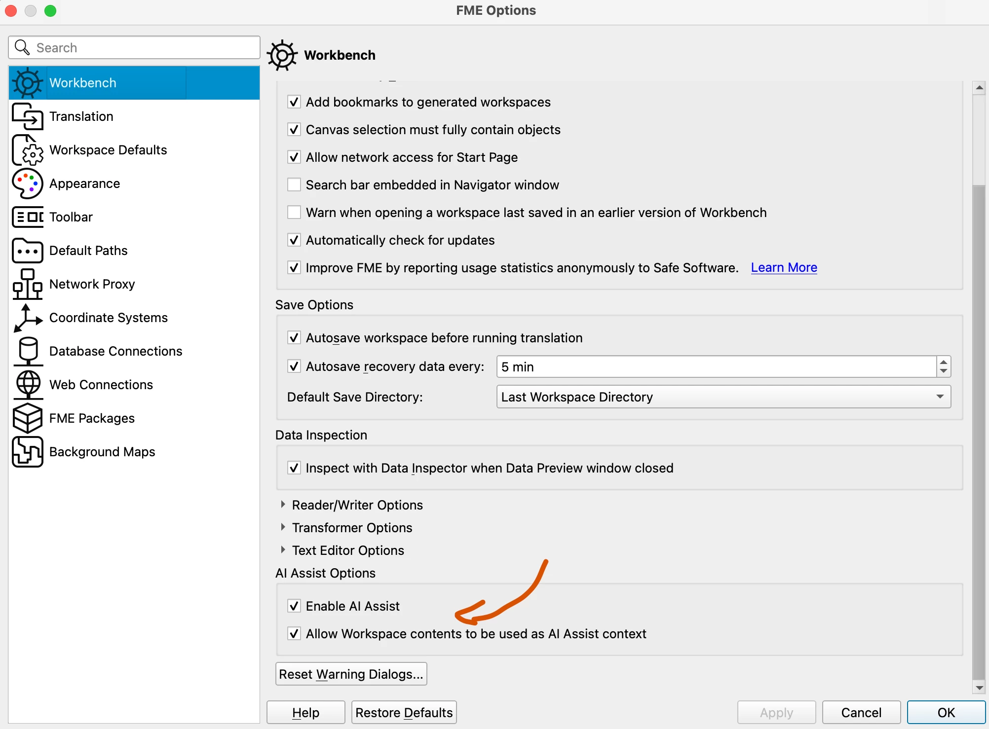

Just upgraded from 2022 to the latest version for Flow and Form. Whenever I publish a workbench the publication works then shortly after the log gets the message “The web connection 'FME Account' could not be loaded”
We don’t have a Web connection “FME Account “ and the task has completed anyway. Any ideas where this is coming from?

Hi ​@rob_m_esriuk
I haven't experienced this issue before, but I’m happy to work with you and the community to dig into this! 🙂
Is the error message you mentioned in Form or Flow? Also, would you be willing to share that log file? (with log debug enabled for Form)
As for the “FME Account” web connection, while I’m not confident in the cause, I’m curious if you have AI Assist enabled on Form? I’m not aware of any similar reported issues, but I know this Form feature does use FME Account to verify users.

If you want the warning/error to go away
  • sign in to AI Assist
  • or untick the AI Assist under the FME options

Happy to say this issue will be fixed as of 2025.2!
