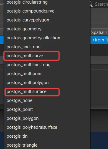

For reading, no problem at all for FME. For writing, I can specify the geometry type :
If I have polygons, they are casted as multisurfaces and all is good.
But when it comes to dynamic, how can I achieve to set this parameter dynamically ?
I’ve try to use “from first feature” but curvedpolygons objects (even if I cast them to multi) are not mapped to multicurve ou multisurface and I can have polygons as first features (I can not control the order).
Note : for cuves (lines), you can use the pathBuilder to convert it into geometries that will be cast to postgis_multicurve. But nothing for polygons :-(
I’ve try to use “from schema definition” but I can not find a fme_geometry_type that correspond to postgis_multisurface or postgis_multicurve.
I’ve looked into the Postgis.fmf metafile but it seems there is no specific geometry type mapping.
So, is there a way to define a native geometry datatype to use with a dynamic writer ?

No — you can’t directly define a PostGIS “native geometry datatype” (e.g. MULTISURFACE, MULTICURVE) in a fully dynamic writer.
The schema (including geometry type) is derived from:
  • input data
  • first feature
  • or a supplied schema definition
There is no fme_geometry_type value that maps cleanly to:
  • postgis_multisurface
  • postgis_multicurve
Maybe a workaround is a GeometryFilter leading into multiple FeatureWriters that has the geometry definition explcitly defined, rather than use first geometry

Hi ​@j.botterill,
Thank you for your answer !
I’m currently using the workaround you propose but this is unelegant :-)
I was searching for some king of black magic were you put a magic formula in a specific fme_field and “voila”…
I will create an idea for that.
Thank’s
