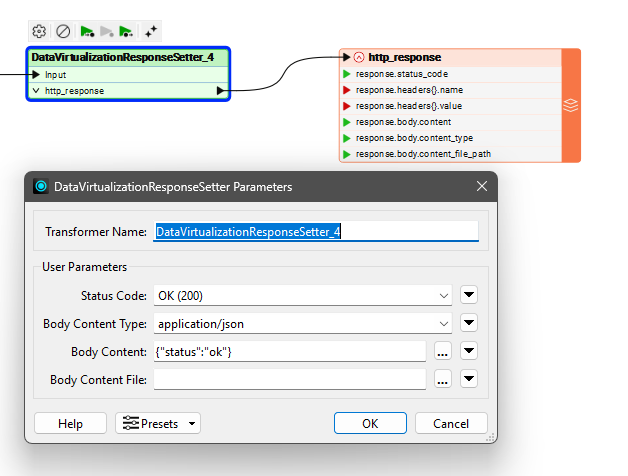

Data Virtualization Writer
After manually setting these with an AttributeCreator a few times, I thought: why not create a tool to make this easier?
So I made the DataVirtualizationResponseSetter !
This transformer takes care of setting all the required attributes, and gives you a list of predefined values for common fields like response code and content type.
While this helps format your features for FME, you still need to build your JSON responses manually—using AttributeCreators, JSONTemplaters, etc.

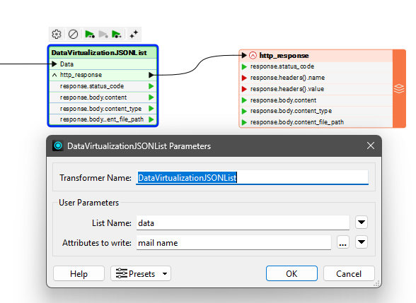

DataVirtualizationJSONList
It turns incoming features into a structured JSON array and sets the proper HTTP response attributes.
Example output:

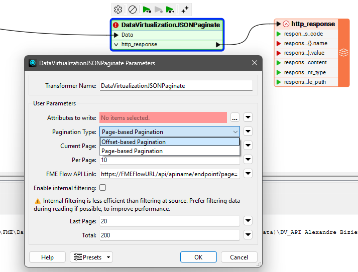

DataVirtualizationJSONPaginate
This one handles pagination and includes metadata in the response, so it's great for building paginated API endpoints.
Example:
"data": [
{ "id": 101, "name": "Item 101" },
{ "id": 102, "name": "Item 102" }
"meta": {
"offset": 100,
"limit": 2,
"total": 1000

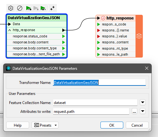

DataVirtualizationGeoJSON
This one generates valid GeoJSON from spatial features and wraps everything up nicely into a FeatureCollection.
Example:
"type": "FeatureCollection",
"name": "example",
"features": [
"type": "Feature",
"geometry": { ... },
"properties": {
"CODE_DEPT": "39",
"NOM_DEPT": "JURA",

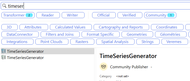

For a weird reason when I try to add them to my workspace it glitch, I don’t know if it’s related to the beta version (2025.1), the Hub, or the Transformers.
For example I add the JSONPagination, this on loads fine, but f i try to add the GeoJSON one it fails and load the ResponseSetter, same thing if i choose the JSONList, it adds the ResponseSetter instead.
If i choose to add ResponseSetter first I can’t load the other ones and it  keeps adding ResponseSetter instead of any of the 3 other Custom.
alexbiz
Forum|alt.badge.img+35
  • May 12, 2025 2:21 PM UTC
Yes there might be a problem with both FME 2025.1 and FME Hub.
I think FME has an hard time loading CT using others CT inside of it. I’ve had this issue too.
As well as FME Hub glitching out, hiding some of my CT or duplicate others...

I was testing GeoJSON Custom and I get this message.
Data Virtualization Writer: Unrecognized content-type, please verify content-type: application/geo+json.
I can make it work if I change the content-type to application/json.
I was wondering if it’s working on anybody’s side.
alexbiz
  • May 12, 2025 3:43 PM UTC
Hmpf I’ve set the content-type to application/geo+json hoping FME will be ok with us using whatever we wanted. I guess we’re stuck using a list of preset content-type.
I’ll update the DataVirtualizationGeoJSON with content-type set to application/json.
I’ll keep it updated with the information we have, but we’ve got no documentation about that for now.
