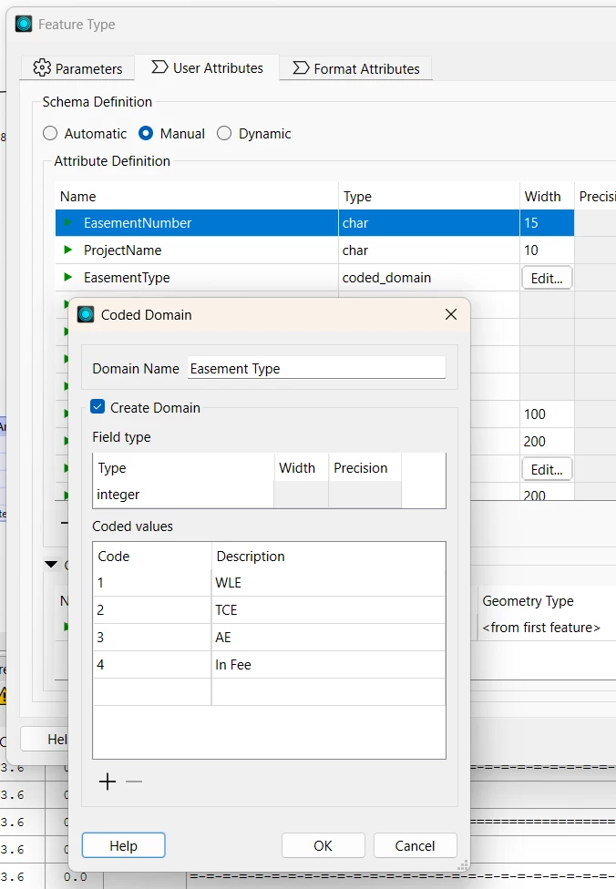

I just found that in the geodatase_sde writer, you can create domains for the field you’re creating. This is very exciting news! And the domain is indeed created in the SDE database. However, when I view the featureclass in arcpro, the domain for that field is not there. I still have to associate that domain to that field. Has anyone tried this? Is there a parameter i’m not seeing? I’ve checked all the parameters around the field, the feature type, the writer and didn’t see anything that could be it. The documentation didnt have any info except on how to create the domain. bug or feature?

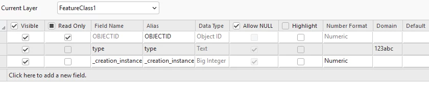

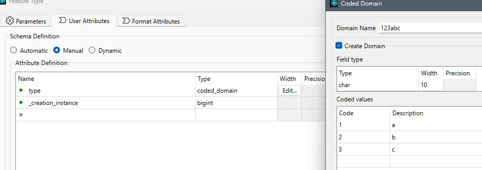

I don’t have access to SDE to test with, but doing it to a standard GDB works as I’d expect (in 2026.1.0.0). You can see the Domain is linked to the correct field
