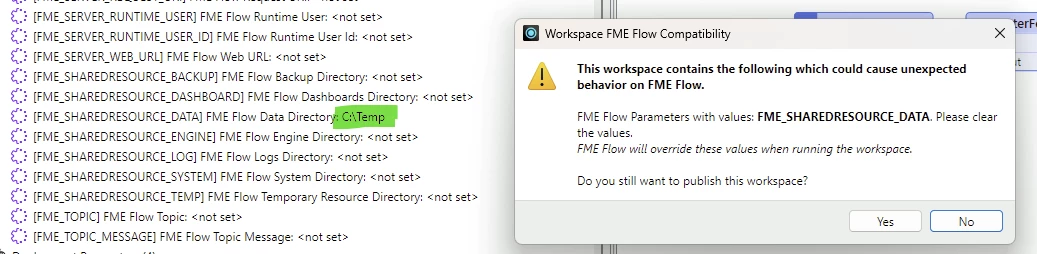

hkingsbury
Forum|alt.badge.img+73
  • Feb 11, 2026 7:41 PM UTC
What version of FME are you using?
When I try to publish a workspace with a specified value there I get a warning that Flow will overwrite the value:

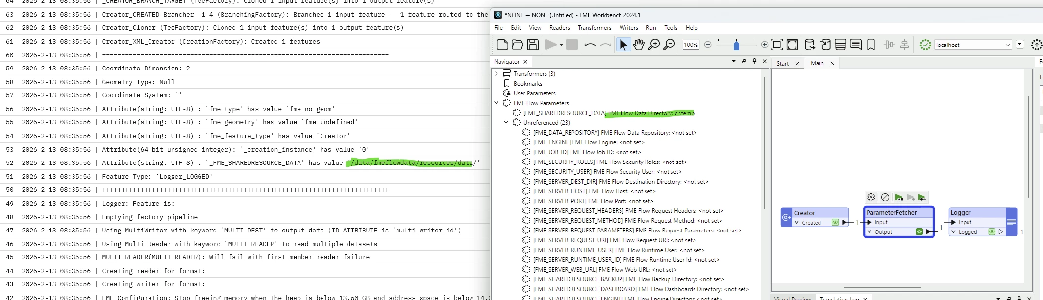

hkingsbury
  • Feb 12, 2026 7:37 PM UTC
I’ve just test with 2024.1.
It doesn’t give you a warning, but looking at the behavior of a published workspace, it does overwrite that value:
