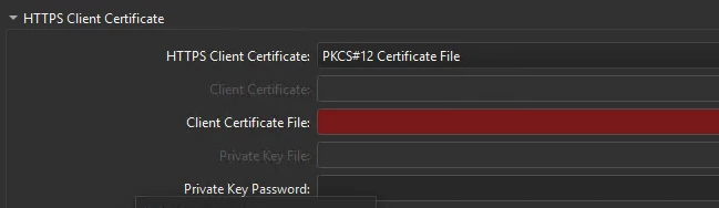

​@LizAtSafe mentioned that the feature is released. I can find it nowhere in the documentation. Could someone point me to the right direction on how to authenticate at an API,using a certificate?

Is it not this section under the Advanced settings in the httpcaller?

Advanced… There it is…. I was looking at Authentication…
Thanks, as always,  ​@ebygomm and ​@david_r
