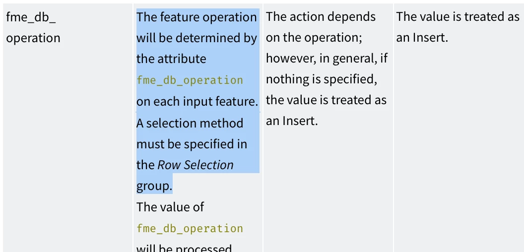

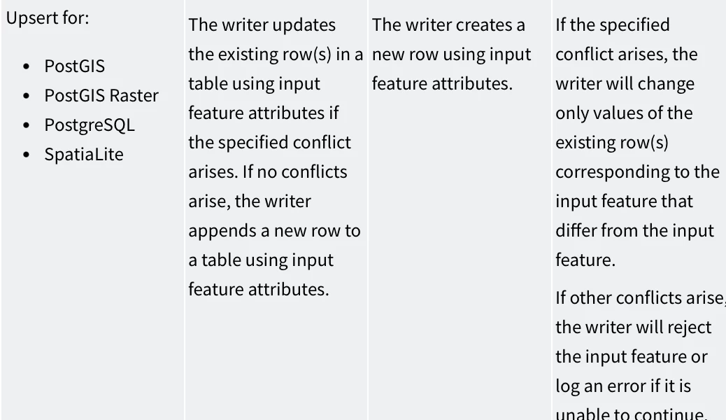

This is what I’m reading… that ArcSDE/Enterprise Geodatabase supports separate insert and update operations, but not a combined upsert action as a single database command.
PostGIS, SpatialLite, Oracle, SQL… but not ArcSDE?
If you need upsert functionality, it must be implemented at the application or workflow level (such as in FME, using join/match logic… or through use of the ChangeDetector and its fme_db_operation output), not as a native table operation in ArcSDE/Enterprise Geodatabase.
https://docs.safe.com/fme/html/FME-Form-Documentation/FME-ReadersWriters/DatabaseWriterMode/feature_operations.htm
