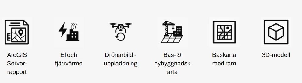

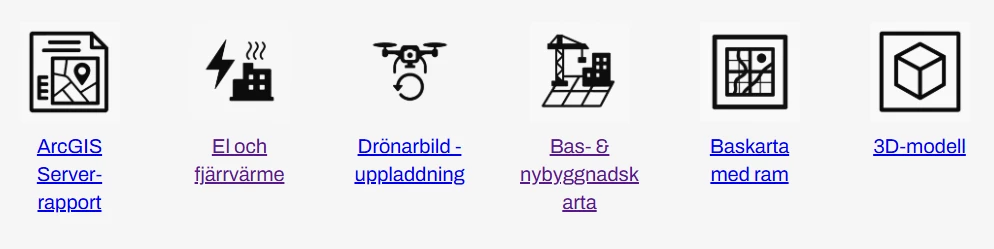

After upgrading from FME Flow 2024.2.3 to 2025.2.4, the labels (titles) under Gallery Apps are now rendered as blue, underlined hyperlinks.
Previously, the labels were displayed as plain black text without underline, even though the entire app tile was clickable.
2025.2.4:
2024.2.3:
Are there any built-in configuration options or recommended approaches to control the styling of Gallery App labels? We are aware that other organizations have experienced the same issue after upgrading from the same versions.

Hi ​@mcsjo,
Thanks for the questions!
Regarding the blue Gallery App labels - I’ve reached out to our development team, and it seems like this change was unintentional. I’ve filed an internal issue on this, so hopefully it will be addressed in a future release.
In terms of custom styling for Gallery Apps - unfortunately, custom styling is not something that we currently support for Gallery Apps, or Flow Apps in general. I would highly suggest sharing your thoughts on this related product idea thread:
Our product ideas page is monitored closely by our various teams here at Safe, so sharing your thoughts here will help increase visibility and also allow other users to vote and comment on your ideas!
Please let me know if you have any other questions!
