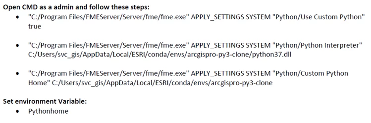

Hello Everyone,
I hope you are doing well.
I ran the below scripts to set it to custom python interpreter. I would like to know the default settings for FME server to revert back to original settings ?
 Thanks,
Naveen

Hi Naveen,
Thank you for your question.
For FME Server 2021.2, the embedded Python versions are as follows, as referenced in Safe Software's Build Numbers article:
  • Windows: Python 3.8.9 and 2.7.18
  • macOS: Python 3.8.9
These are the default Python interpreters included with the installation. If you are configuring custom Python environments or require additional control over script execution in FME Flow (formerly FME Server), the following documentation provides helpful guidance:
Using Python with FME Flow
