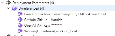

Much the same with the deployment parameters, when I connect to Flow Instance A, I have the following:
And connecting to Flow Instance B:
