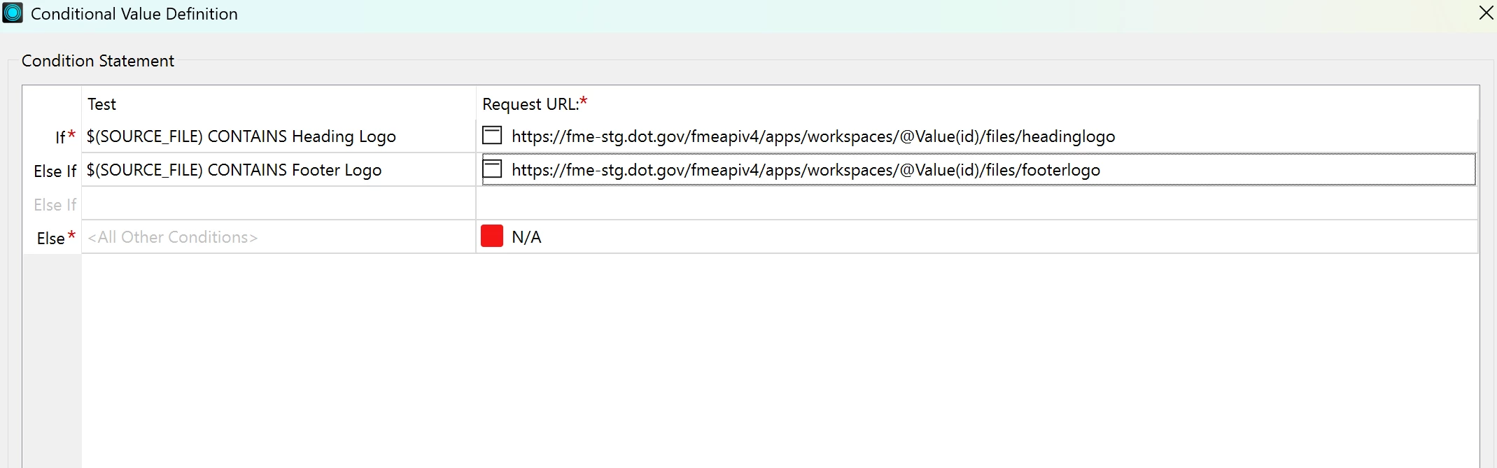

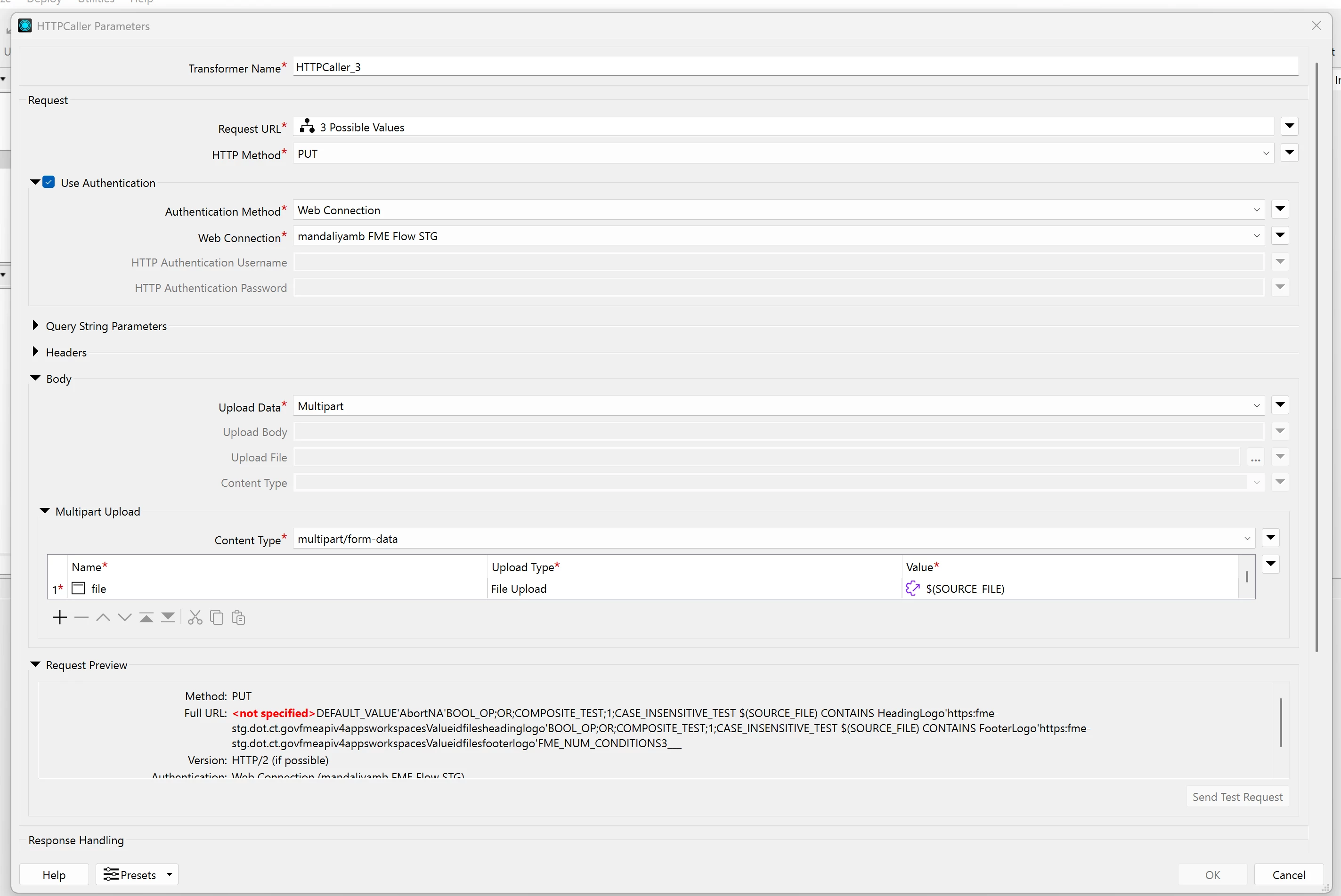

Hi ​@david_r  ​@hkingsbury  ​@toyosia, I tried through the V4 REST API but when I add conditional statement to Request URL I am getting <not specified> in request preview of URL. In this link  Automating FME Flow App Customization they have created user parameter name SOURCE_FILE but in request URL they use UPLOAD_FILE.
