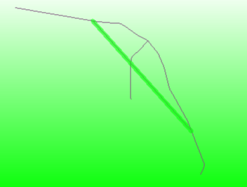

I have this line (the green one):
And I want to calculate the shortest path from the start of the line to its end across the network (the violet one).
How can I do it?

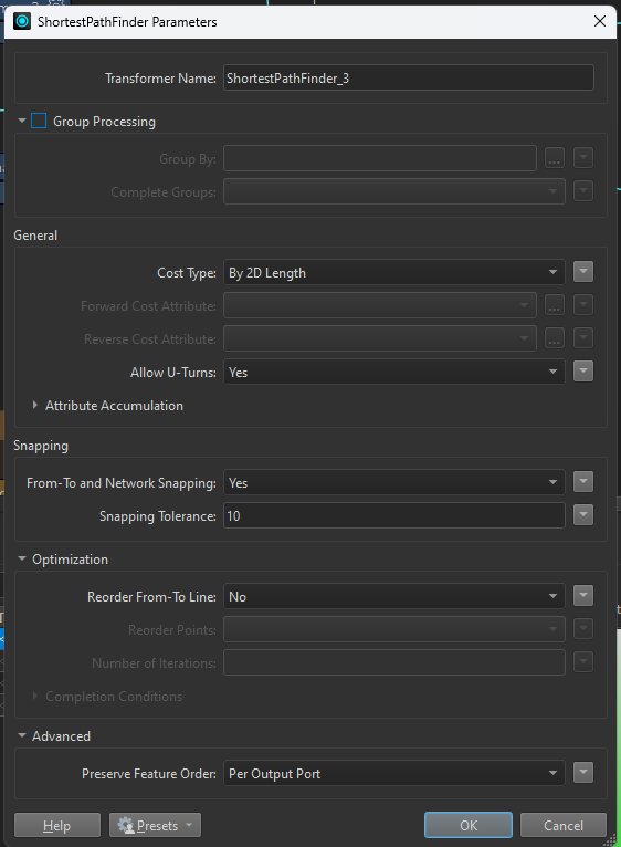

What is it the right way to do it? How can I set the parameters of the “ShortestPathFinder”?

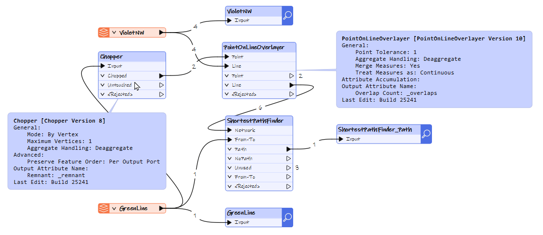

Hi ​@gbcfgeo2025 The default parameters of the ShortestPathFinder will do just fine; but to get it to work you’ll need a properly noded network, which means nodes in the network which align with the ends of the From-To line(s).  I’ve used a Chopper and a PointOnLineOverlayer to do that, but you could also use an Intersector, TopologyBuilder, etc.
