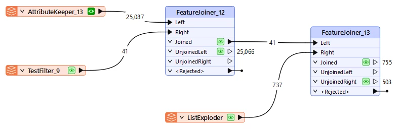

When running an old script in FME 2024.1.1.0 we get 58 errors “The object at location ___ was previously deleted and cannot be retrieved from the Object Stash” (see attached log file).  It doesn’t appear to affect the output, the log file says “Translation was SUCCESSFUL” and CPU and Memory usage don’t get close to 100%.  Can we ignore these errors?
This is part of a much larger script but only this part is producing the errors. We updated the transformers and saved the script to FME 2024 but still get the errors at the transformer FeatureJoiner_13.  The only way to not get the errors is to run the script up to the 2 preceding transformers (“Run to this”) and then run FeatureJoiner_13.  The output appears to be the same as when we were getting the errors.  We tried adding in FeatureHolders before FeatureJoiner_13 but still got the errors.

Hi ​@donalmateer,
I didn’t understand all your suggestions (listed above) but I was able to simplify the FME script to the minimum that would still produce the “Object Stash” errors.  It appears to be the data coming out of FeatureJoiner_12 that is causing the errors but I can’t see why.
I’m not able to share the script but I’ve attached the FFS files and here is the setup for the 2 FeatureJoiners.  Hopefully you can reproduce the errors.
Thanks for your time and Happy Christmas.
Doug

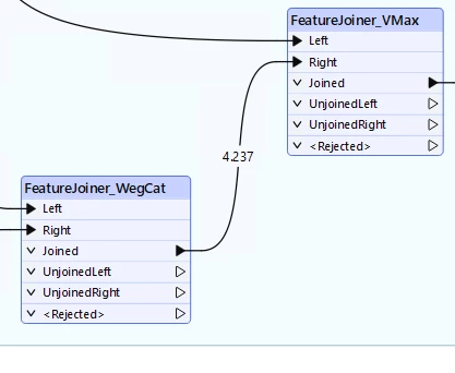

Two FeatureJoiners, and lots of errors from the second FeatureJoiner:
Doesn't seem to affect the results.
I get this error on both FME Form and FME Flow (both 2024.1.3 Build 24627), so I would not expect the error to be related to feature caching.
Both FeatureJoiners are set to Join Mode: Left.
