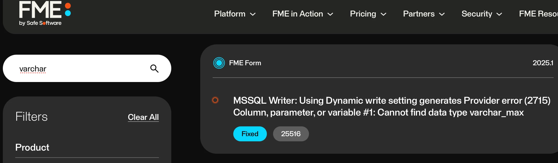

Best answer by j.botterill
On the FME downloads page, there is a change log. I can see a bug fix implemented in 2025.1 version
Download this version of Form and see if it helps.

  • Aug 7, 2025 5:13 AM UTC

​@j.botterill
FYI the newest version fixed the issue.
