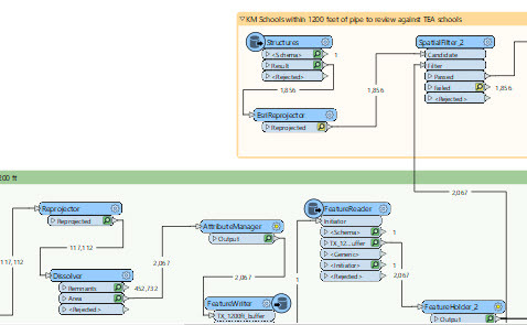

When I run my spatial filter with the entire dataset the filter fails but if I run using partial data the dataset it works.
Does anyone know why this would happen?
Note: Spatial Realtor works but not the spatial filter.

A few ideas to test:
  1. what settings on spatial filter do you have? https://docs.safe.com/fme/html/FME-Form-Documentation/FME-Transformers/Transformers/spatialfilter.htm# read up about the Tests>Filter Types about how to process filter vs canditate
  2. add a decelerator (0.2sec) and find out where the features are accumulating.... you may want to place a featureHolder somewhere if you can't get the setting in 1. optimised

We also kind of need the settings of both your SpatialFilter and the SpatialRelator. And what do you mean with 'the filter fails'?
I tried Multiple settings in the spatial filter. Filter type = 'Multiple', Pass Criteria = 'Pass Against All Filters' and Spatial Predicates to Test = 'Within' and 'Intersects'
Also, Filter type = 'Single Filter', Pass Criteria = 'One Filter' and Spatial Predicates to Test = 'Intersects'
As for the realtor I only tried it using all of the Requestor OGC options.
When I say failed I am referring to the Passed/Failed outputs in the spatial filter transformer.

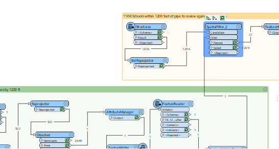

I've got it now. I was confused by the transformer parameters. I thought all of the 'Tests' where referring to the 'Spatial Predicates to Test'. I didn't realize the 'Filter Type' and 'Pass Criteria' are referring to the input by which I am filtering the candidate.
Thank you for clearing that up for me.
