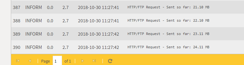

I have a script which is fetching multiple images with an imageFetcher. Sometimes the external services stops responding and the script never stop running. See pic attached showing the last rows from the log.
To avoid building a never ending queue I would like to limit this specific script to 15 minutes but I don't find any built feature. I have tried some python callers like timer and time.sleep but nothing really matches the requirement.

It looks like you're using an older version of FME Server, e.g. 2016?
Newer version of FME Server lets you set a running job expiry time:
Running Job Expiry Time (optional): The time, in seconds, a job will remain in the running state. This directive is used to ensure that a job does not hang and block an FME Engine indefinitely

It would probably work if all features finishes but the problem is that the image fetcher gets stuck in the middle of it's own process so the time stamper that follows will never be initiated and the script will never finish.

Yes I'm running 2015 but an upgrade to 2018 is initiated so that is good news.
I thought it was a global time limit but it looks like it will be possible to set the time limit for specific jobs. Thanks!
