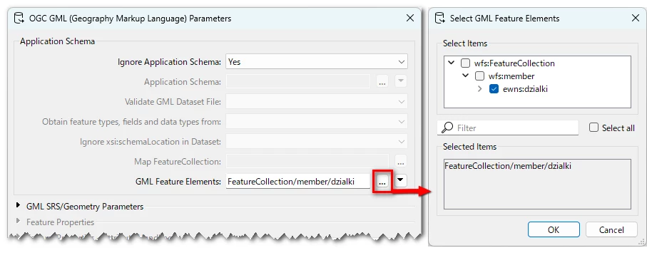

To avoid the failure, try setting the path of the feature element "ewns:dzialki" to the GML Feature Elements parameter in the OGC GML reader manually when adding the reader to the workspace.
Set Format and Dataset in Add Reader or FeatureReader, open reader parameters dialog from [Parameters] button, then you can select desired feature path from the browse button [...].
Hope this helps.
Hope this helps.

​@mwoj ​@takashi rightly pointed out the source for the error: the GML reader cannot retrieve automatically the schema for XML namespace "http://xsd.geoportal2.pl/ewns"
I checked the correctness of the GML file in QGIS and was able to open it!
However in FME, if you set the path of the feature element "ewns:dzialki" to the GML Feature Elements parameter in the OGC GML reader manually as mentioned by ​@takashi you should be able to read the GML file.
