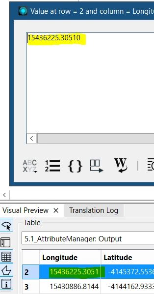

So I want 5 decimal places.   eg.     15436225.30510
However, what I see in my result table viewer is 15436225.3051   (no trailing zero)
But when I double click on that value, it displays the value “with” the zero.  15436225.30510
The value that gets written to the writer (to AGOL) is the one without trailing zero.
Works fine until I use a change detector, then it decides that the trailing zero is causing a difference and wants to update the value to have the trailing zero.
So my question is,  can I enforce the trailing zero in the table result?  Then I will rewrite my destination records one time again and hopefully my change detector will realise they are the same from that point on.

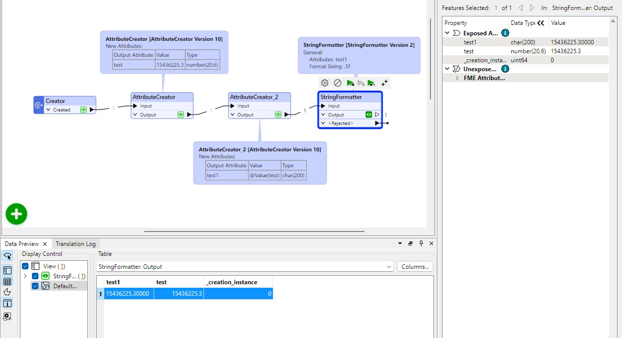

I feel like this might be a bug where two parts of FME are fighting against each other. (ones saying pad it to X dp, the other is saying, well 0 at the end of a decimal isn’t needed, so drop it)
You should be able to convert it to a string and at the DP there. Don’t worry about it being a string, as the writer should fix it up correctly when its written
