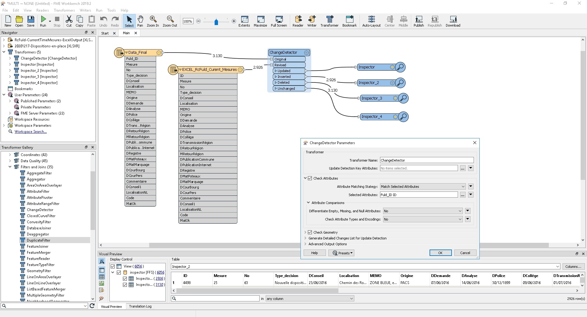

acusig
Participant
Forum|alt.badge.img+1
  • Participant
  • Dec 17, 2020 4:03 PM UTC
Here it is.
david_r
  • Dec 17, 2020 4:08 PM UTC
Here it is.
The problem is that the primary keys aren't called the same in both tables. As it is currently configured, the ChangeDetector will try to match based on the combination of both ID and Fuld_ID on both tables. Since one table only has ID and the other only has Fuld_ID, there are no matches.
Try renaming "Fuld_ID" to just "ID" on the "Data_Final" input before the ChangeDetector. You should then remove "Fuld_ID" from the ChangeDetector settings.

It's working, thanks a lot for your help !
My bad, I changed the field's name to ease selection from two different sets but didn't thought (nor understood from docs) an exact match was needed for the transformer to work.
