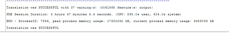

nath
Forum|alt.badge.img+7
  • Jun 11, 2025 4:47 AM UTC
I dit it again and this was the result
itsmatt
Forum|alt.badge.img+48
  • Jun 11, 2025 7:25 AM UTC
OK yeah, so here indeed there is only about 25 mins of CPU time being used - is 25 mins about what you saw pre upgrade? It does suggest that FME is waiting somewhere.
Things I would check:
- Is the workspace running from a network location?
   - This can slow down execution for several reasons.
- Are you writing to a network location?
   - Does the performance change if you write the data to a local location?
- Memory usage is pretty high - it could be that memory usage is too high, this could certainly be something which may have changed with your upgrade. A slightly higher memory usage could push the process above a limit causing a slow down.
- Are you still running with feature caching on?
   - This should probably be turned off.
- Where is your fme temp location? Is it local and on an SSD?
  - FME will output quite a few temp files, this can be especially true when the memory of a process gets really high. A temp location on a slow hard drive or worse still a network drive can have a really big impact on performance.
- Try just reading the data from the database into an inspector (disable the rest of the workflow). Here you can rule out the slow database read.
Logging with timestamps on as ​@mohamedalsobh suggested (Tools > FME Options > Translation > Log Settings > Log Timestamp Information)
