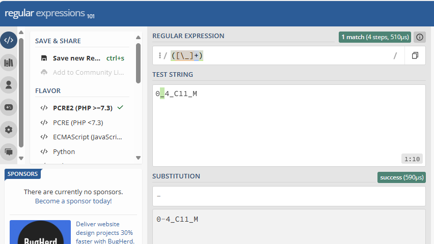

I am trying to replace just the first underscore in the string with a dash with a regex replace to change the name from 0_4_C11_M to 0-4_C11_M. The regex I’m using is ([\_]+)
When I test that expression in RegEx101 is does exactly what I need and only replaces the first underscore in the string as shown below:

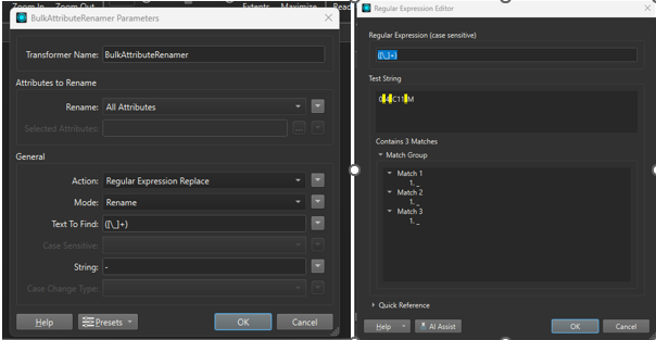

However, when I use the same expression in the BulkAttributeRenamer it’s returning and replacing all underscores as shown below:
Hoping someone can help with advice on how to limit the return to just the first underscore in the string please - it the expression incorrect or is there something else I need to add to the parameters? Thanks :)

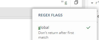

Just as an FYI, if you are using regex 101 for testing you want to make sure global is enabled, as this is generally how FME is implementing regular expressions
