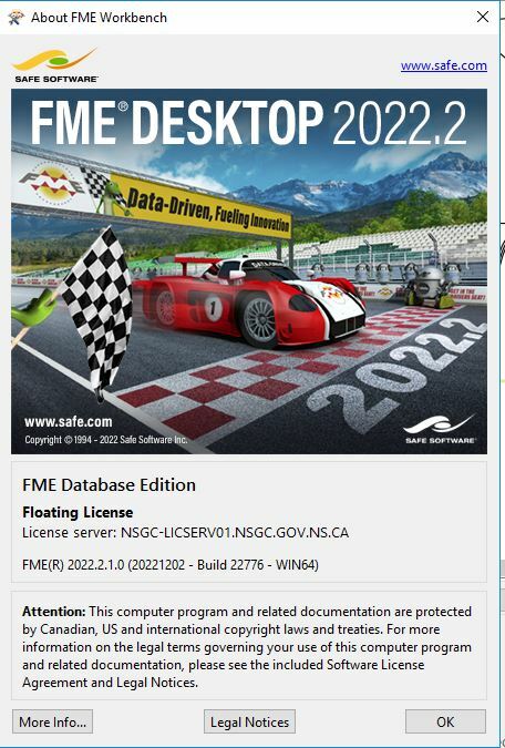

Our FME Version being used is FME Desktop 2022.2, I have also attached a copy of our current workbench and one of our zipped CARIS MU Units as an example.
