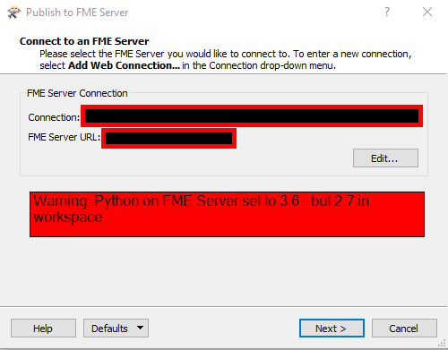

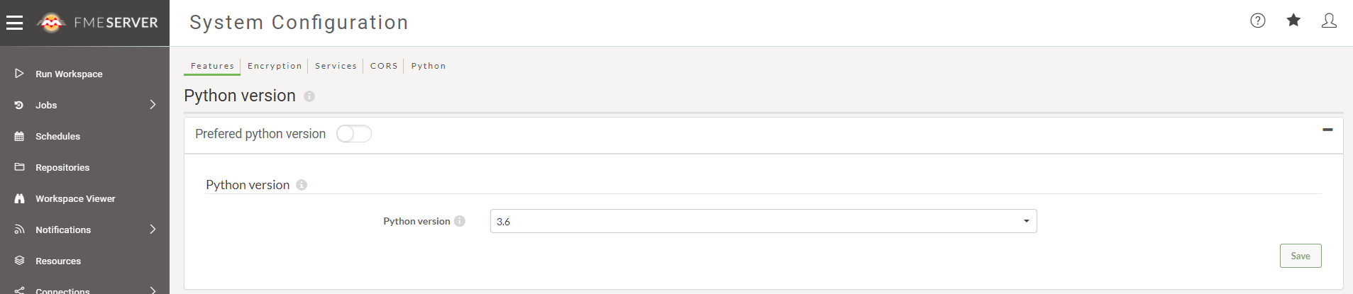

GUI-suggestion on FME Server:
Which will result in a warning when publishing workspaces to that server:
