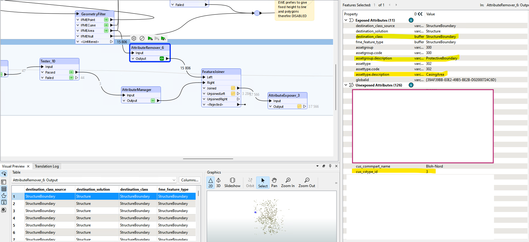

And here you can see how the data from port one looks:

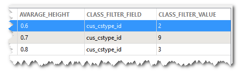

Here is what the Excel file looks like:
I’m basically trying to filter the data (output of AttributeRemover_6, see first image) where:
  • destination_class_source = StructureBoundary AND  assetgroup.description = InstallationBoundary AND assettype.description = CabinetBoundary and cus_cstype_id = 2

The filter information comes from the Excel file (second image).

These attributes come from an Excel file that I am reading. CLASS, ASSETGROUP, and ASSETTYPE exist in my main data as part of the cus_cstype_id attribute; however, it is not exposed.

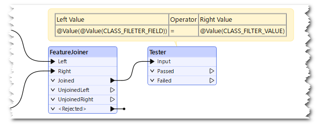

takashi
  • Jun 6, 2025 7:10 AM UTC
According to your screenshot, @Value(CLASS_FILTER_FIELD) returns the string ‘cus_cstype_id’, won’t return the value of attribute called ‘cus_cstype_id’.
If the feature has unexposed attribute named ‘cus_cstype_id’ and you want to retrieve its value, @Value(@Value(CLASS_FILTER_FIELD)) will return your required value.
@Value(@Value(CLASS_FILTER_FIELD)) returns the same value of @Value(cus_cstype_id), if the value of CLASS_FILTER_FILED was ‘cus_cstype_id’ - the case of your screenshot.

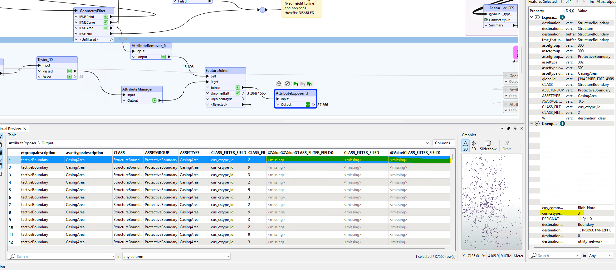

I added further explanation and image how my data looks like where i  try join the excel or filter.
The problem is i have to first use the value of CLASS_FILTER_FILED  which is cus_cstype_id to expose a future in another dataset.

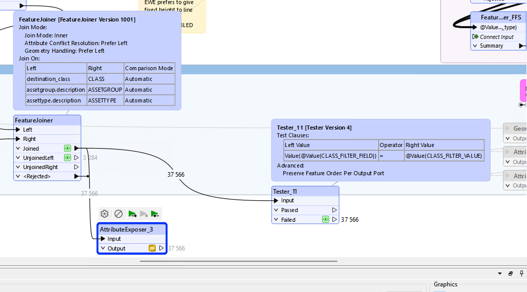

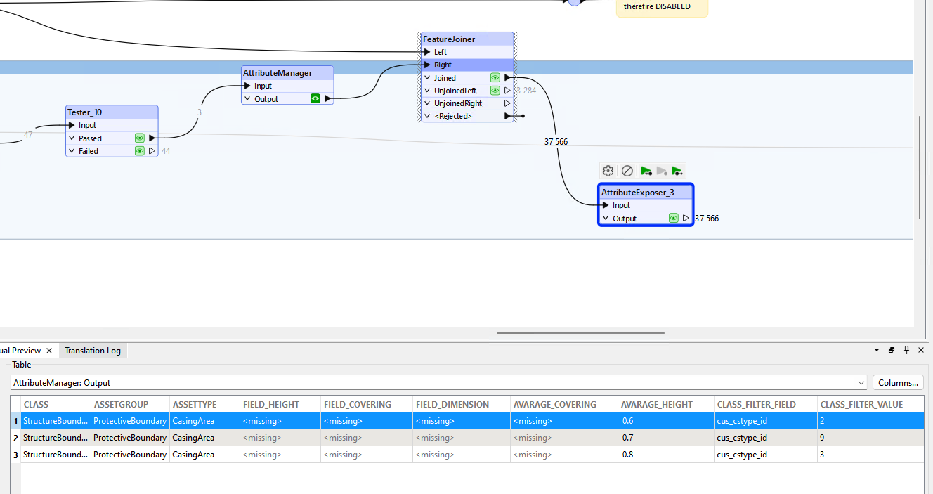

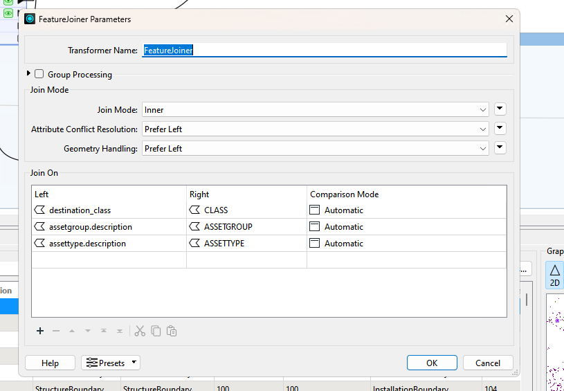

​@takashi I join the dataset with FeatureJoiner and the parameter looks like this
With these my data get the CLASS_FILTER_FILED  and tried 3 methods to compare and see if the expose works and noone of them works.

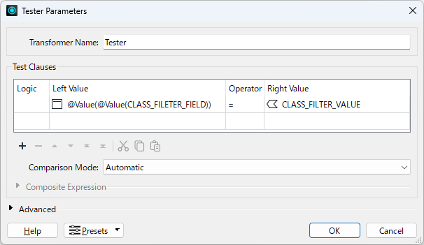

OK. If I understand the requirement correctly, this procedure could help you.
  1. Merge the Excel features to the main features with FeatureJoiner.
Left Right
destination_class CLASS
assetgroup.description ASSETGROUP
assettype.descriptioni ASSETTYPE
  1. Filter the joined features with this test clause set in a Tester.
@Value(@Value(CLASS_FILTER_FIELD)) = @Value(CLASS_FILTER_VALUE)

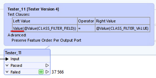

  • Jun 6, 2025 10:42 AM UTC
​@takashi all the objects are failing because @Value(@Value(CLASS_FILTER_FIELD))  is not exposed. See my screen shot above. I tried all 3 variation and none of them return any values
takashi
  • Jun 6, 2025 11:01 AM UTC
You don’t need to expose any attributes. Have you configured the workflow as I suggested?

takashi
  • Jun 6, 2025 12:57 PM UTC
It seems that @ at the head of the expression is missing.
jugoslaviaa
Forum|alt.badge.img+6
  • Jun 6, 2025 1:34 PM UTC
​@takashi Very embarrassing! It works!
You can actually access the attribute with the Tester even if it’s not exposed?
Thanks a ton!
