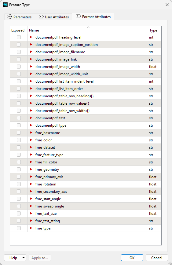

The DocumentPDF Format Attributes to set are:
The pages still come out 8.5 x 11.  I can send a test workspace if needed.

Hi ​@reedwhit , seeing the same behavior here. Did you add those two attributes? I was expecting them to be built-in since they are Format attributes but I wasn’t seeing them and so I added to test but am not seeing any change to page size either. Even tried using the predefined A3 size...still comes out Letter sized.

I checked the DocumentPDFWriter with PDFStyler and PDFPageFormatter in FME 2025.0.2 and I am also getting the letter size pages in the output pdf.
I am not sure if this is only with me, I did not see the documentpdf_page_size and the documentpdf_page_size_unit format attributes in the DocumentPDF Writer featuretype “format attributes tab”

Yeah I noticed the documentpdf_page_size and documentpdf_page_unit missing from the Format attributes list, but thought you could just add them as user attributes anyway. But it’s not working regardless.

thx ​@dbaldacchino1  ​@raghavendrans  for confirming my suspicion, I think the documentation might be ahead of the release.  notice most of the format attributes are hidden.  and some of the writer parameters from the docs are not in the writer.
https://docs.safe.com/fme/html/FME-Form-Documentation/FME-ReadersWriters/pkg-documentpdf/documentpdf_writer.htm
for example Page Size is not shown in the Writer Parameters.
