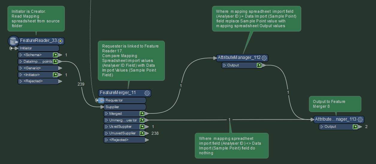

Many thanks for response. I think on balance I will use the Feature Reader/Merger. This adds a few more steps to process (see screenshot) but recognising there is no current method to make the AttributeValueMapper 'dynamic', it works best for my purposes.
