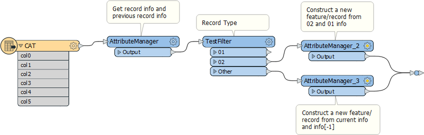

On this same topic, I am trying to wrap my head around how to loop through the text file feature by feature using the CAT reader. Basically each line in the column aligned input file has a series of sub record numbers at the beginning of each line, i.e. 01, 02, 03, etc. Taken together, these sub records constitute one feature and then begin with 01 again for the subsequent feature. Some of these subrecords are optional. Also, the unique feature ID attribute occurs only inside subrecord type 02.
Is there anyway to process the records as a whole using the CAT reader? I am thinking I may need to use Python for this.
I would go with the adjacent feature handling. Personally, I'm not a fan of VariableSetters/Retrievers. I wrote a blog post about how to handle this type of structured data using adjacent feature handling: https://www.safe.com/blog/2017/08/adjacentfeatureattributes-evangelist166/ - although it's not exactly the same structure that you have, it would be a good intro to what you need to do.
I think I would fetch the previous record (so set that value to 1 in the Adjacent Feature parameters). I would Test for line = 02, then use that to construct a new "record" with that info and the info for line = 01 (which it will have fetched). Other lines just take the "record" from the previous feature and add to it.
Basically 01 can be ignored (it gets used by the 02 record). 02 constructs a new record. 03, 04, etc just fetch the previous record and add to it.
