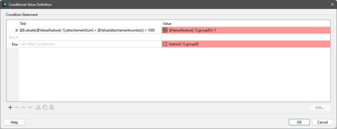

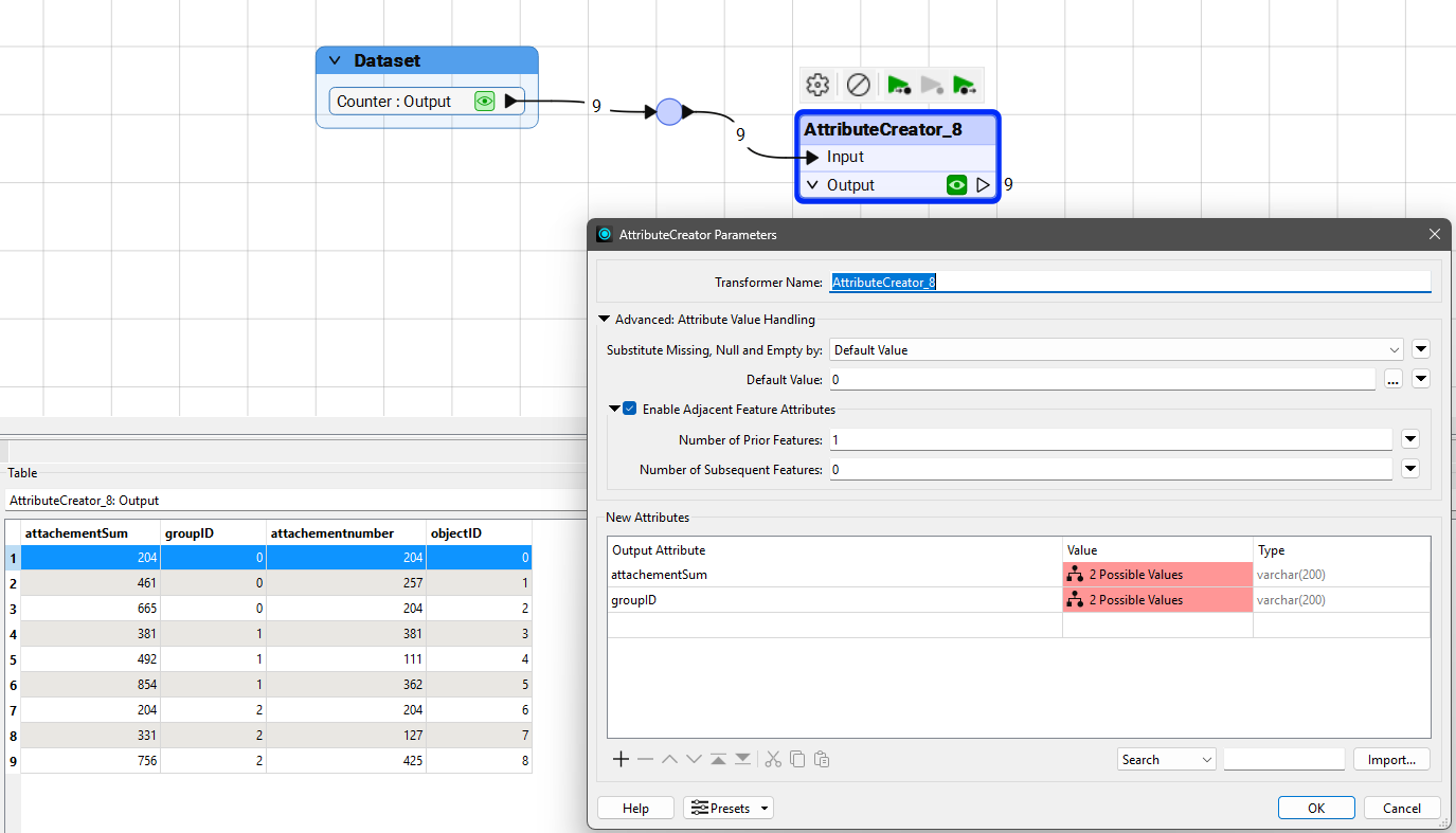

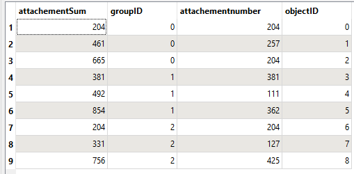

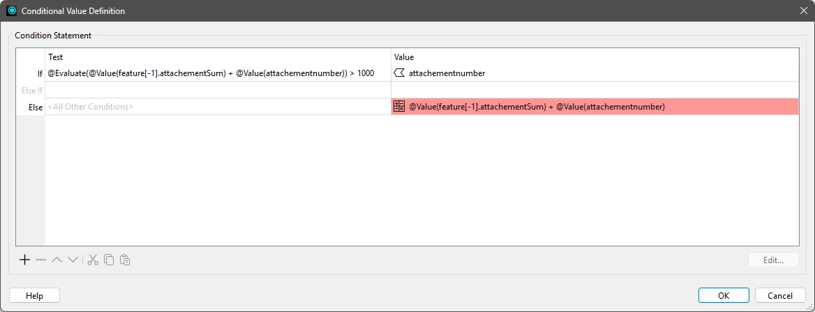

Assuming the following dataset :
One way to do that could be the following
AttachementSum conditional value :
GroupID conditional value :
This method will create groups based on the attachmentSum. Each time the attachmentSum exceeds 1000, the groupID is incremented and the attachmentSum is reset.
It’s a bit tricky, and workbench will give alerts about non-existing attributes, but it will work :
You can then use the groupID attribute to create lists of obectIDs, concatenate, etc…
Tips: In a similar case, I would expose the new attribute names with AttributeExposer beforehand, in order to avoid the alerts.
