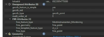

We had the same problem with the dataset of a colleague.
To solve the problem we found the unexposed attribute fme_template_feature_type:
When using a attribute keeper before the writer, this will not cause any problems anymore.
