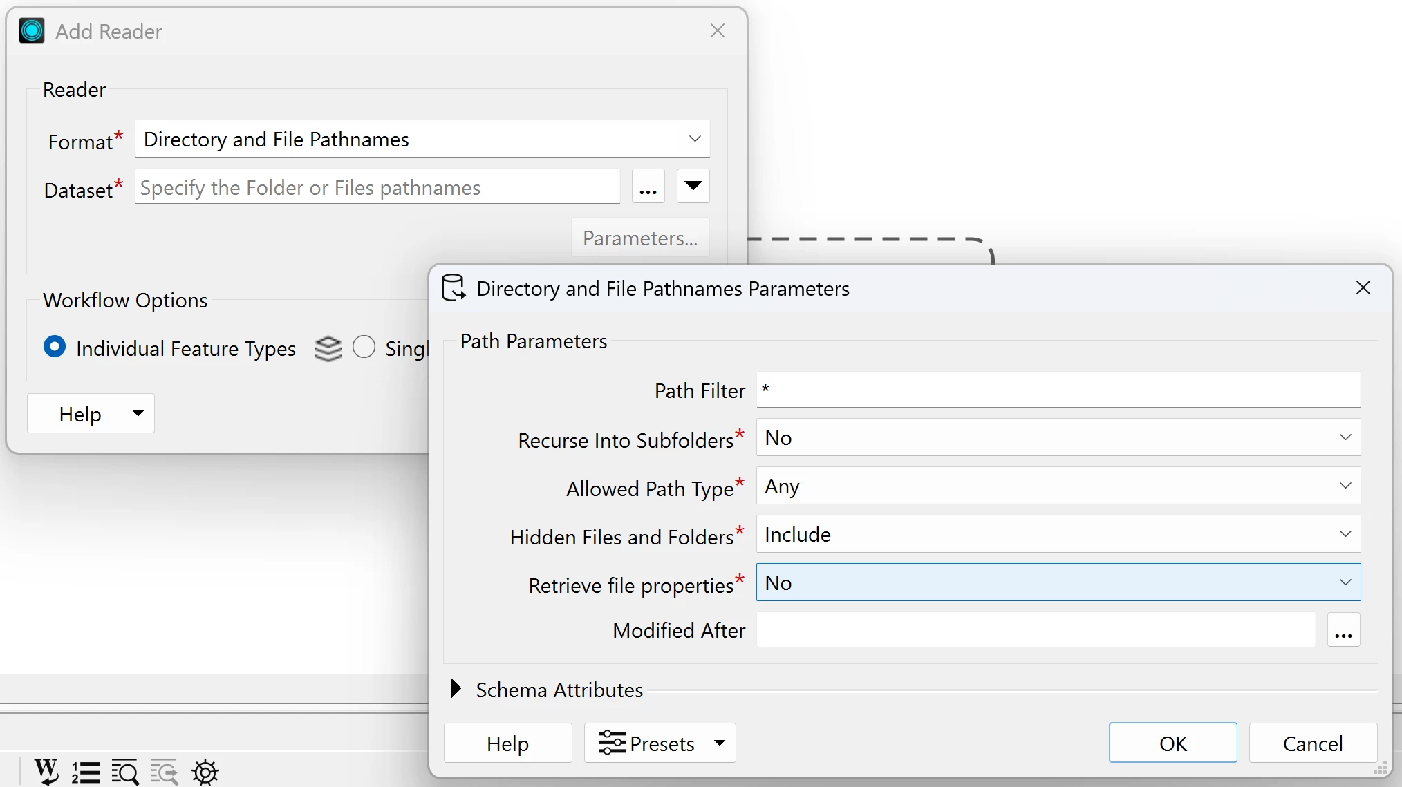

​@kahlen Retrieve File Properties parameter is only available in Reader parameters when you add the Reader:
I had the same issue and ​@danatsafe explained to me that retrieving/not retrieving file properties affects the schema and therefore can only be done when feature type is created.
