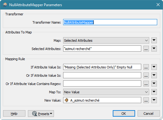

If these are two columns in the same sheet, the simplest solution is probably to use the NullAttributeMapper,e.g.
This will make sure that the attribute "azimut recherché" gets the value from "A_azimut rechercé" if it's empty, null or missing.

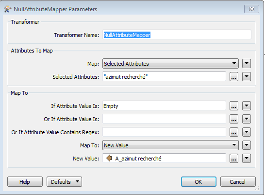

Forum|alt.badge.img
  • Sep 26, 2019 11:42 AM UTC
it works well . I only changed one thing. thanks for your help
