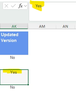

The data in the Sheet1.xml is just the styling i think, not the data itself. I’ve seen this before when someone has made a custom format that contains what looks like data, however it’s actually part of the formatting
If I click on that cell, I don’t see the value of yes in the highlighted yellow box. If i then read the file in with FME i don’t see that yes value either.

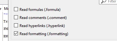

If you need to access, you should be able to see the values you show in the xml by ticking read formatting in the xl reader
You will then have to extract the information you need from the formatting.

I had already tried checking all the check boxes above (formulas, comments, hyperlinks and formatting). They didn’t bring anything useful back at all. In fact, the formatting said that the cell was using Courier New, when only part of the text is Courier New and the remainer is Arial.
