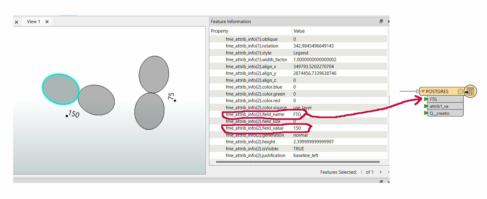

I am converting dwg blocks to Postgres. There are many dwg blocks, and I am writing each block to different tables. In my dwg blocks, there are attributes like fme_attrib_info{1}.field_name and fme_attrib_info{1}.field_value in my output or writer The field name should become attribute name (field name), and the value is from fme_attrib_info{1}.field_value dynamically. Field names are not constant in my input DWG files. What I need is column name, which comes from the fme attribute. Is this possible? pls help me.

I think you can do this using a dynamic workflow combined with the SchemaScanner transformer.

  • Read dwg, do not explode blocks.
  • Generate ID for each item.
  • Expose the lists fme_attrib_info{}.field_name and fme_attrib_info{}.field_value.
  • Explode list fme_attrib_info{} to features.
  • Create attributes from field_name and field_value.
  • Merge different rows into one based on ID.
  • Merge created attributes to original feature using ID.
  • Use SchemaScanner to create Schema Feature for each autocad_block_name with attributes as in data.
  • Use FeatureWriter to write dynamic based on Schema Feature.
