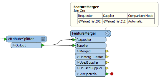

If the IDs are sequential the solution proposed by @hollyatsafe is very fast and efficient. But in case the IDs aren't sequential, the easiest is probably to split the ID into its two parts, e.g. using use the AttributeSplitter on "L", so that "102L63" becomes "102" and "63".
You can then use the FeatureMerger to match the "current" and "next" features.
