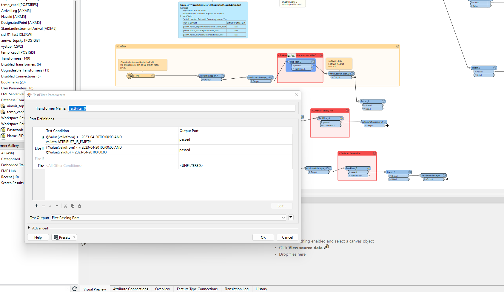

Hello. I would like to ask. I have a workspace where, see the attachment, I have set a time filter (red frames). I would like to store various dates in this format in the database, for example the date for each specific month. Each cycle, a new date from the database would be automatically replaced by this filter based on the number of validly executed workspaces. Can this be solved somehow? I would probably solve the individual cycles with some kind of "counter" transformer, it will be more complicated to insert the date. Go in the direction of some parameterization? How do I ensure that the correct date is always set on the test filter?

Hello @fmesafe.podpora​, sorry if I have misunderstood the ask, is the goal to filter or test by the current date? If so, you can use the DateTimeStamper to create a new timestamp of the current date. Let me know if addresses your question, or feel free to explain further! Best, Kailin.
