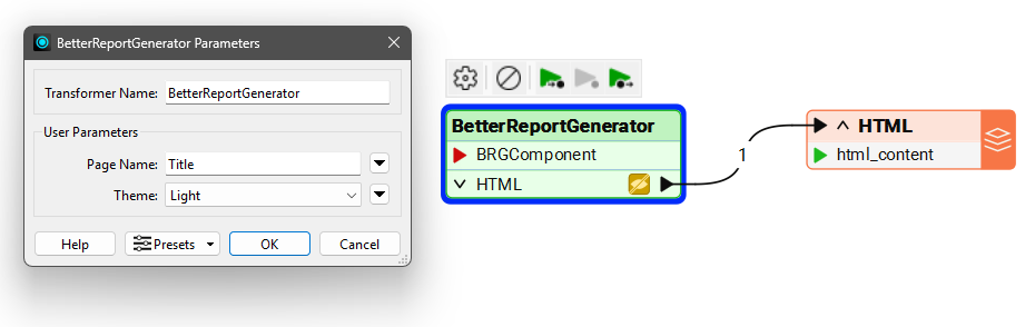

BetterReportGenerator is a compiler transformer: it assembles whatever BRGComponent features you feed it and outputs ready-to-write HTML content.
Instead of packing configuration options into one transformer, BRG delegates the what to a family of specialist transformers and focuses solely on how to knit them together.
In the BetterReportGenerator parameters you only specify:
- Report name
- Theme (Light, Dark, Cream, Deep Purple)
Everything else is dictated by the BRGComponent features you connect.

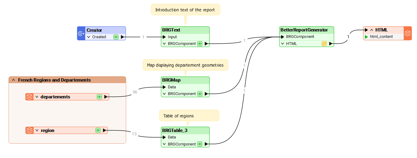

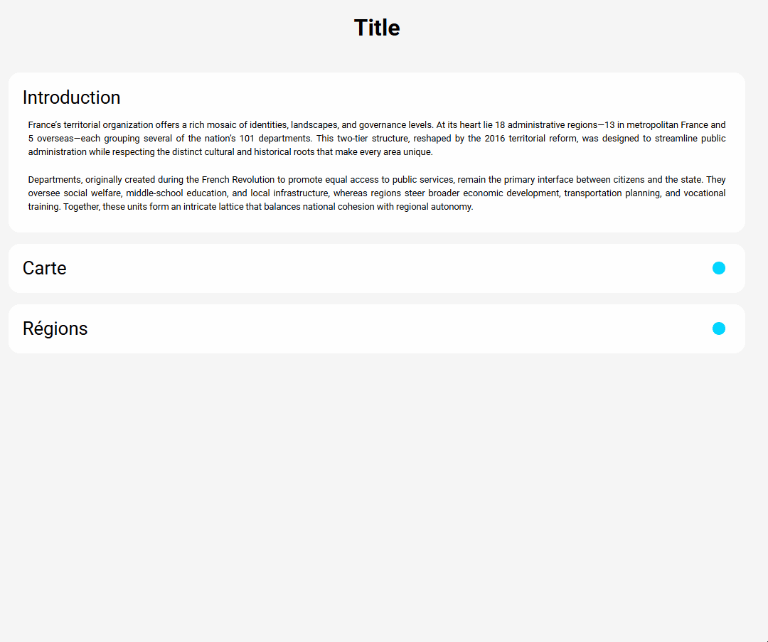

This example would give a report like that :

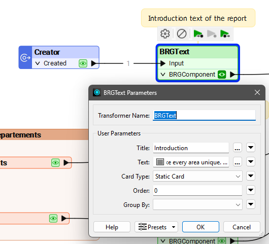

Each transformer has an Order parameter so you control layout order without juggling feature timing.

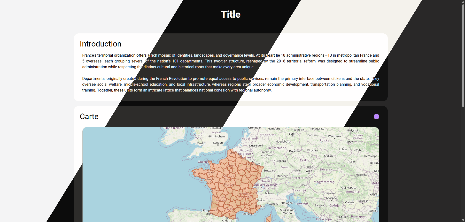

Themes & UX
All themes follow a neutral, Material Design-inspired palette with a subtle accent colour (the Cream theme, for instance, echoes the FME Community look).
Components can render inside collapsible cards with smooth animations for clean, interactive reports.

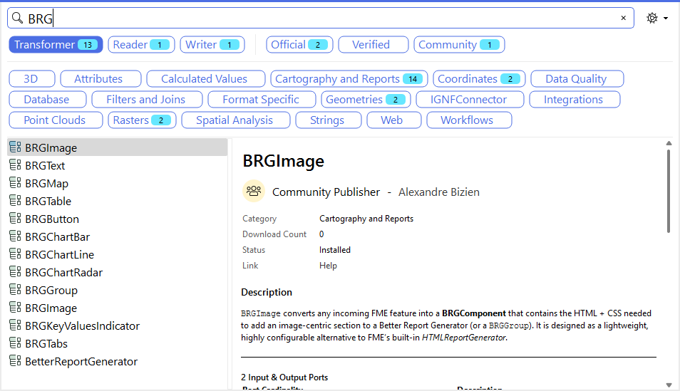

1. Grab BetterReportGenerator from the FME Hub, or in Quick Add, type “BRG” to discover the component transformers.
2. Connect your BRG* transformersBetterReportGenerator HTML Writer.

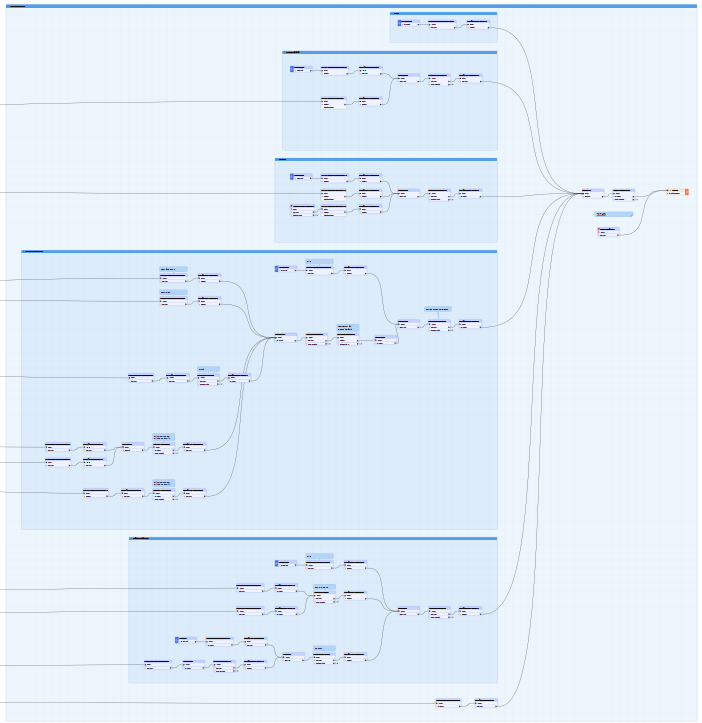

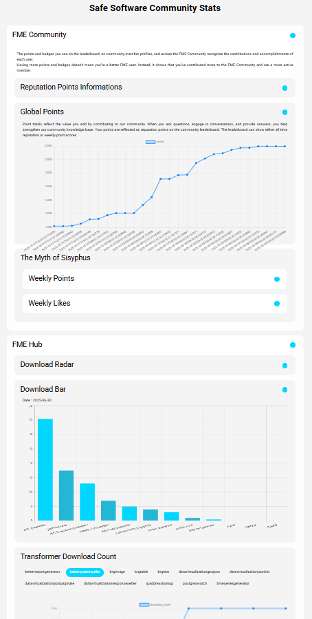

An example of a report I’ve made using the BetterReportGenerator is a Safe Software Community Stats report that I’ve published on a private FME Flow with data streaming webhook.
I’ll attach this example HTML as zip here if you want to consult it and take inspiration.

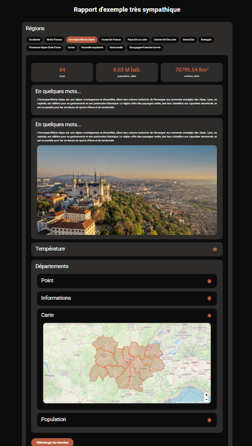

Another one I did explain each French region grouped in tabs :
I’ll upload it too.
