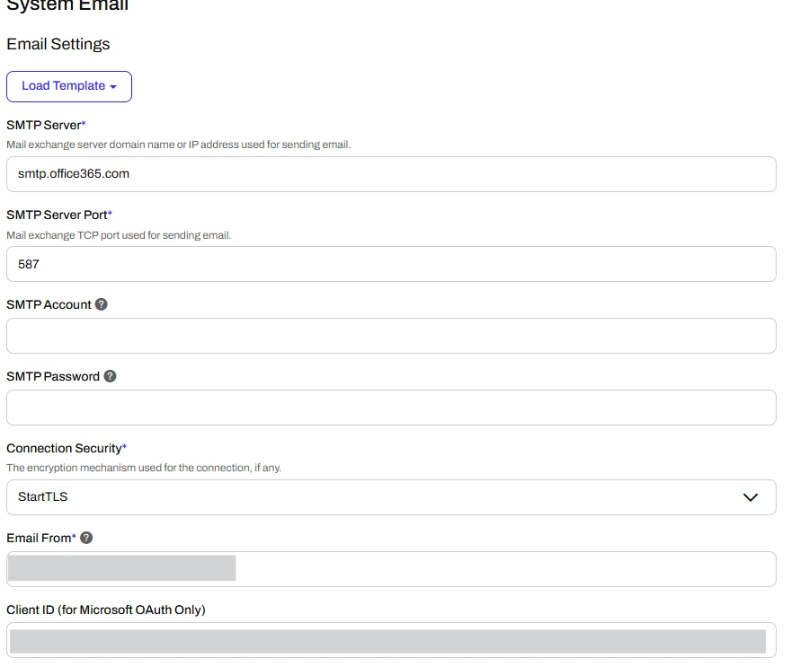

I'm struggling with the following. I'm trying to set up the System Email settings on our FME Flow to allow users to request a password reset. It all seems pretty straightforward but can't get it to work. Maybe i'm missing something though (it is friday afternoon after all). I've set it up as follows:
But when i validate it I get the error:
“Due to a configuration change made by your administrator or because you moved to a new location you must use multi factor authentication to access…...”

Hi ​@jeroen_hack,
Sorry to hear that you’re running into this issue!
Unfortunately, in order to get Flow’s system email to work with a Microsoft SMTP account, MFA will likely need to be disabled on that account. This article has more information (it references using an SMTP account to send emails in an Automation, however the same concept applies in this case). This is not the case when using the Emailer transformer, which could explain why you haven’t experienced this issue in the past.
