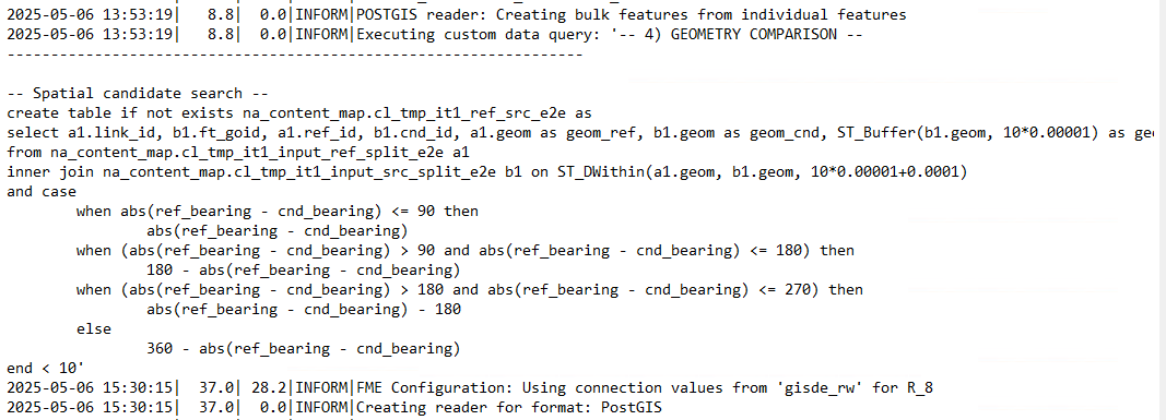

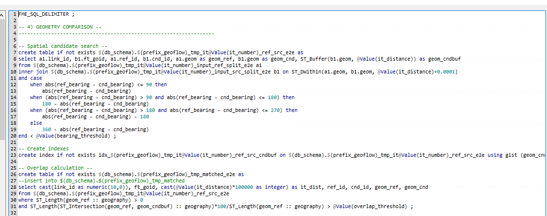

Hi,
When launching a workbench using mostly SQLExecutors, with long sql statements, I can only see the first few lines for those statements on the Log file, for each SQLExecutor, but not the full SQL statement.
Is this something that cannot be modified?
I’d like to have all SQL lines that have been through the process.
log file
workbench
Thanks,
Juanma
