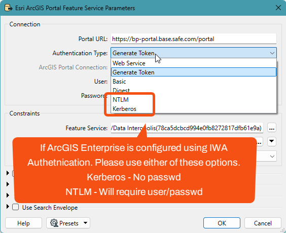

Hi ​@sunnywaygis
To use Web Services, OAuth currently only support ArcGIS Build-in or SAML authentication.
If you have your portal configured with IWA (web authentication), you can access the service by setting the authentication to either Kerberos or NTLM

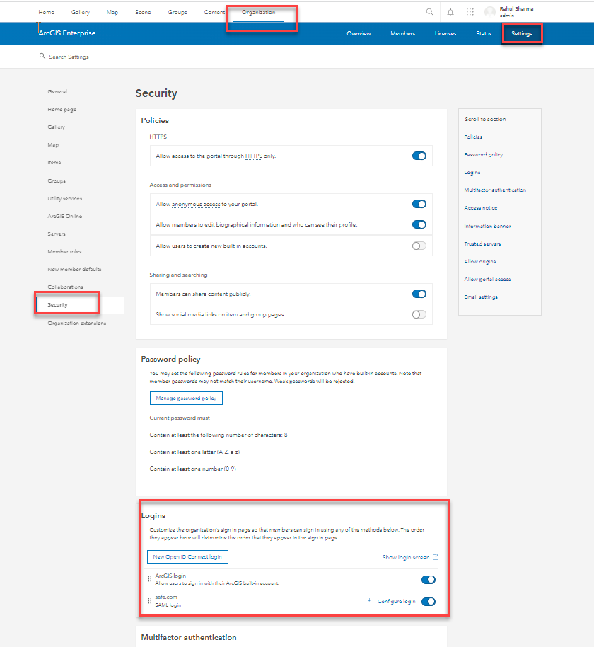

Can you verify that your ArcGIS Enterprise/Portal is configured to use SAML authentication?
You can verify this information from your GIS Administrator
or you can simply check in your ArcGIS Enterprise by browsing to this location
Organization → Settings → Security → Logins
Since the error is 401 Unauthorized .. It is prudent to ask if the USER trying to access the Portal have permission to connect using OAuth or not.

Thanks Rahul for your reply. We use IWA for authentication within our Portal. I also checked Portal logs, don't see specific error for user in portal logs. I am able to login to Portal site without any issues. Does it have to SAML authentication for FME Form to connect to Portal?

Thanks Rahul, I was able to connect to services using NTLM method on the reader. I really appreciate your help.
