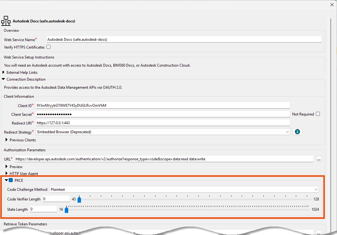

Hi ​@johnglick! I came across your post, and I figured a reply would (hopefully) still help you and the community.
But FME actually generates these values for you! - The code verifier and code challenge -
To use PKCE in FME, you just have to set the challenge method - SHA-256 or Plaintext
In most cases, the code verifier length and state length can safely be left at their default values unless the OAuth server’s documentation specifies otherwise.
Hope this helps! 🙂
