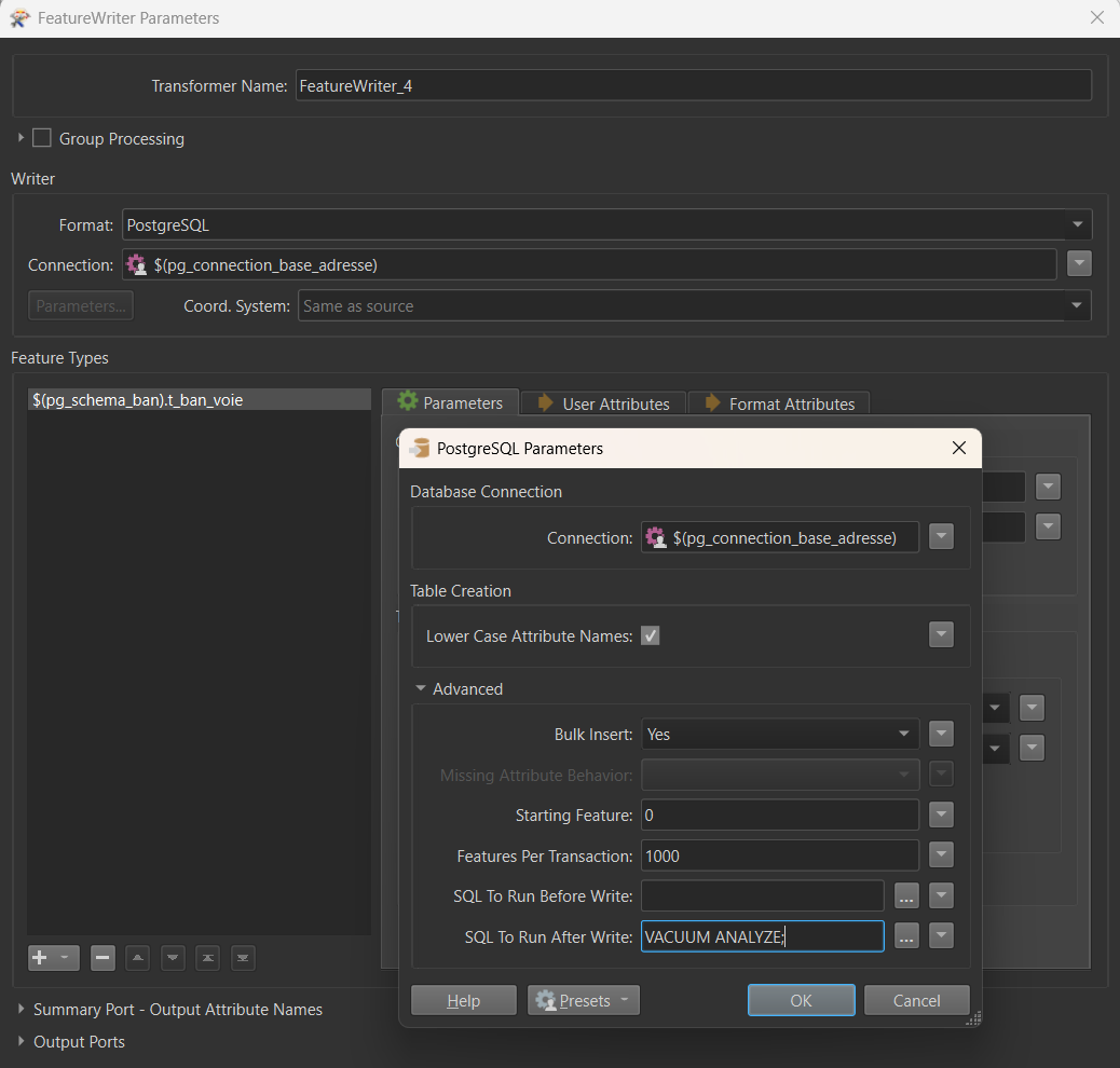

You can send a VACUUM Statement to PostgreSQL in the “SQL to Run After Write” parameter of a featureWriter.
Another option would be to run the VACUUM within a “Shutdown Python Script”

Thanks for the advice but unfortunetly it is impossible in my context. I use SQLExecutor to achieve some updates into the database with complexe functions and procedures.
I cannot use a FeatureWriter as it is not the transformer used at this stage of my translation (there is no need to write or update feature into the workspace into the DB).
I cannot use the Shutdown Python Script because there are other operation after that.
I currently use PythonCaller with psycopg to connect to the db and run the VACCUM FULL which works but is unsatisfiying in my opinion.
Pay attention, VACUUM ANALYZE can be run into a translation but VACUUM FULL not ;-)

You could put it on the initiator output port of your SQLExecutor
Instead of the featureWriter you could even have a FeatureReader connecting to your postgres database and do the VACUUM FULL in the “run before/after“ of a dummy read on any table.
psycopg will work fine in any case.
Also note that VACUUM ANALYZE won’t run in a transaction. A simple ANALYZE will
