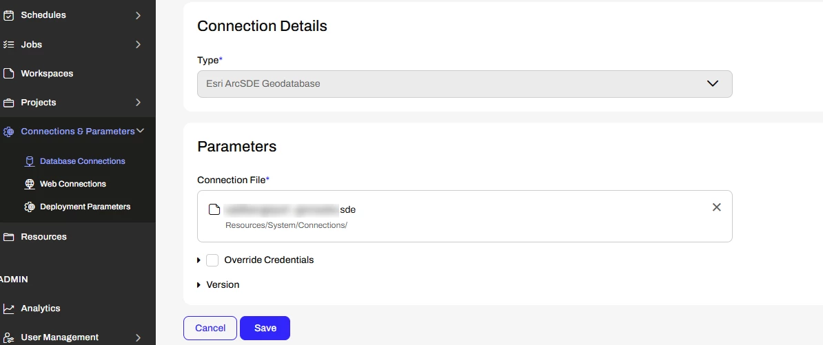

In 2025, we now have the option to store database connection in FME Flow. We can change the dataset path from local to the Shared Resources on FME, either the Engine or the Data folder.
Flow database connection with SDE type

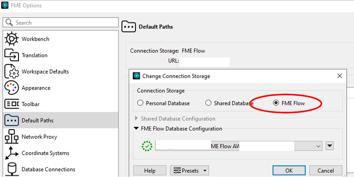

This enables further re-use of the connection within Flow… however the problem then becomes how can FME authors manage the connection in Form?
FME Flow connection storage is great, but not necessarily for SDE file database connections

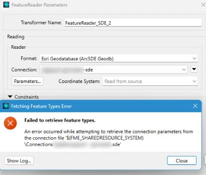

In practice, you go to re-use the flow connection for SDE and despite the path being to Resouces (engine and shared to roles) the error is repeatable
Error’s connecting to feature types in ArcSDE geodb encountered in 2025.1
The workaround for now is to follow Option 2 in article https://support.safe.com/hc/en-us/articles/30212601575693-How-to-Create-and-Manage-Esri-Geodatabase-ArcSDE-Connections-in-FME  storing a single SDE file in a network share location that is accessible to both Form and Flow
